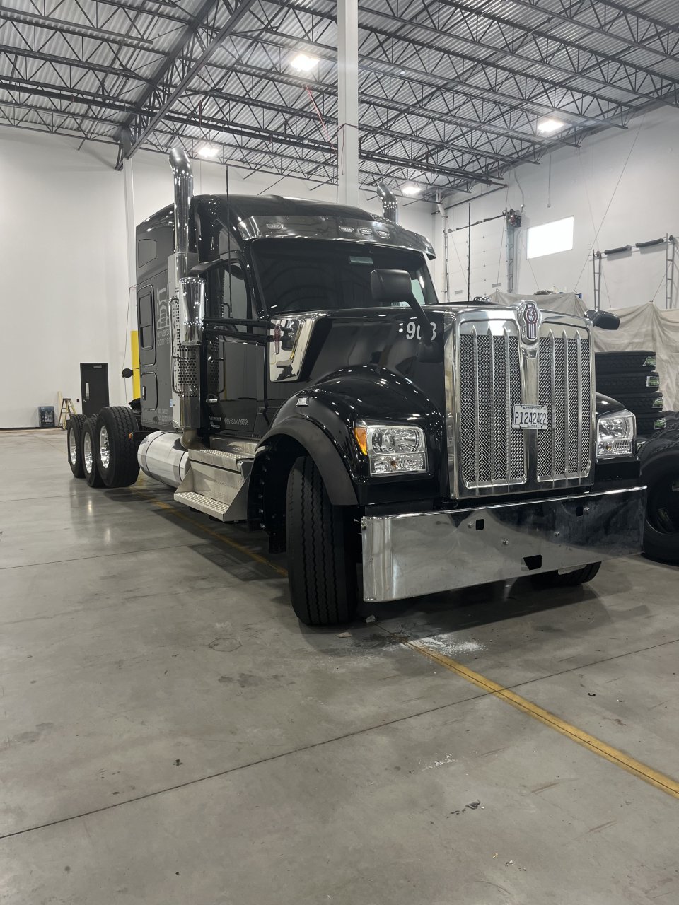

    it will be a 2025 Kenworth W 990. it will have the Lyft axle and tires steer tires rated at 20,000 46,000 just for the drives I think. it will be double frame and I’m not sure but I think it will have a wet kit. It will have an APU it’s one of the three Kenworth’s W990 in the fleet odometer will be roughly 140,000 miles 78102884877__BBDECB98-FB6B-475A-9898-A5DBFEDCB47D.jpeg
    it will be automatic 18 speed
