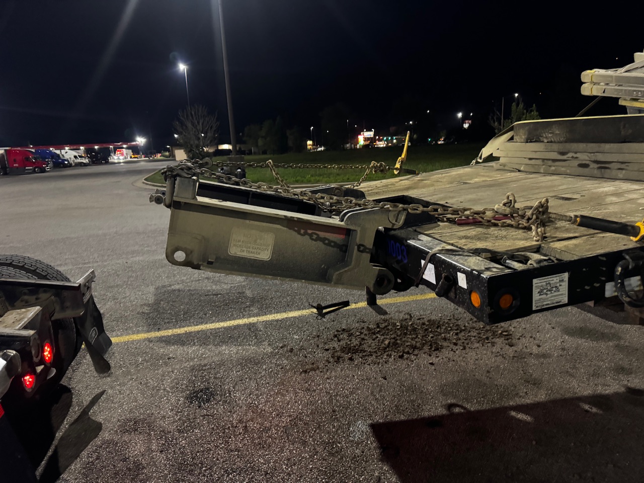

    Back to the flip neck. I think I have IMG_9114.jpeg figured out how to use it when I need to disconnect from the trailer. see picture below
    before disconnecting from the trailer, put a chain in binder on the D rings of the flip neck to hold her place when I disconnect my fifth wheel.

    The flip neck looks weird in the image that’s because when I had flipped it down I had forgot to take the rollers off main neck so I was resting on that and I had to use chains and binders to relieve the tensions off the rollers so I could take them off.

    How are you planning on getting the bottom pins out of the flip box while hooked up? Does the flip box have rollers?

    You use the main necks rollers for the flip box. You have to remove the rollers because that's where the top pins go of the flip box attach to. I didn't have to touch the bottom pins at all.
