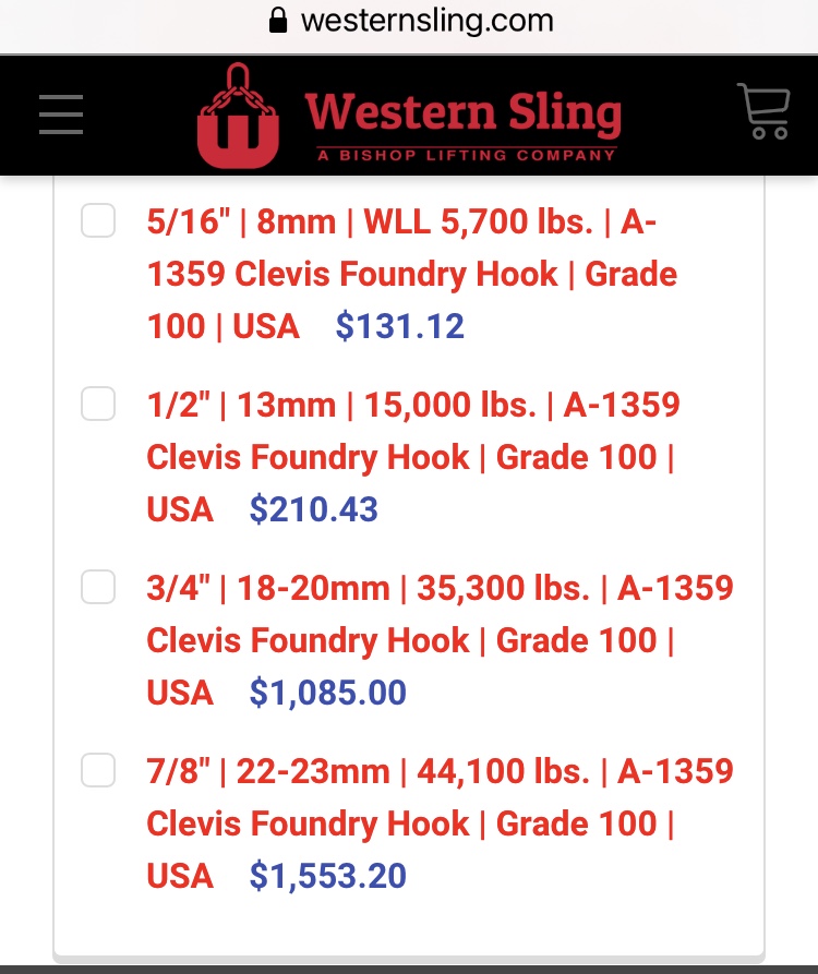

    Recently I've started moving some bigger equipment at work, 70 ton excavators and the like. I've run into problems securing them. The steel webs on these machines are too think to get a 1/2 slip hook onto. Now I've been able to make it work other ways but it sure would be nice to have same options.
    This brings me to my question, have any of you used foundry hooks or J-hooks in this application? All the J-hooks I've been able to find aren't rated at enough to bother with. I think grade 80 Foundry hooks would work for me, but at $120 CAD a piece they're awful expensive. Any other suggestions?
    Another problem I have is not having enough distance between the load the and float for the binder with its two grab hooks plus chain and its two slip hooks. I'd like to be able to put a slip hook directly onto one end of a binder but my 1/2 slip hooks wont fit around the ring of my 1/2-5/8 chain binders.
    Ideally I could solve both problems at once and put a foundry hook directly onto a binder, but I'm not sure the best way to go about this without spending a lot of money. I would think 4 of these would be enough for me. Any help would be much appreciated.

    Try grade 80 here for $58.00:
    Or better yet, grade 100 here for $85.00 :

    I have Grade 80 Crosby hooks chains on my 3/8" 100 grade chains. Their WLL matches or exceeds the chain.
    I don't tie to track pads. The guys who work for Cat hauling the big stuff all have either foundry hooks or slip hooks on their chains, at least on one end or some of them. Good ones aren't cheap, but it sure saves a lot of time. I have grab hooks on everything, but am considering getting some short pieces with foundry hooks for the factory tie downs that I can either hook a binder to or the grab hooks on my existing chains, to save getting the shackles out.
