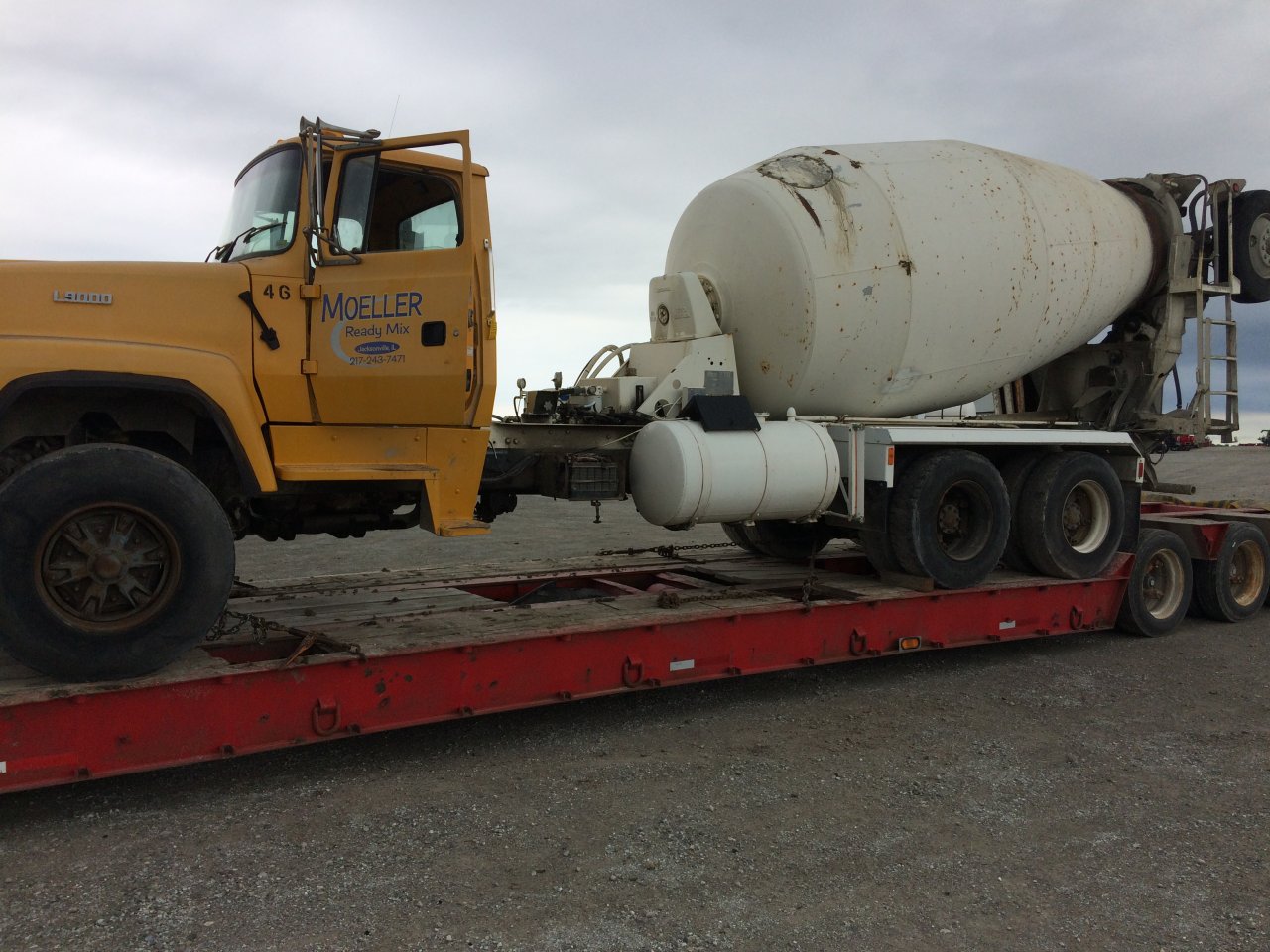

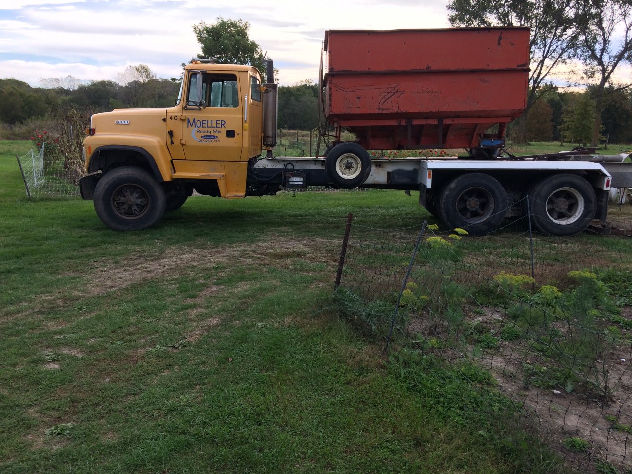

  10. W923
    W923 Road Train Member
    1,332
    4,061
    Feb 28, 2022
    Old ready mix truck…built like a tank and very low resale value if the mixer is junk….unfortunately you will be stuck with an m11 or other small block engine IMG_2999.jpeg Paid 4200 for this one 65634672660__7AFA764D-31E8-4647-B5A7-853470C6EF38.jpeg
    Did a little grain hauling lol could take in 1400 bu with 2 more wagons behind IMG_4854.jpeg was going to put a box on it but ended up using it for a semi
    Ruthless Thanks this.
