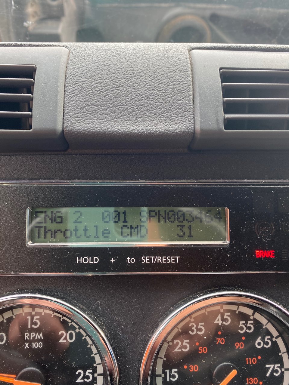

    Hello everyone, this morning I got this light up on my dash, eng2 001SPN003464 throttel CMD. 31
    Anyone has any idea as to what refers to?

    The ECM is logging a fault. THROTTLE malfuction is minor....a cmd fault. Its being stored for the tech back at the shop. Do not try to clear it. Keep Running unless the truck becomes unsafe to drive. The Freightliner shop can clear all the faults when doing a routine pm and advise you what happened.
    You should log date and time the fault happened so you can reference to it if it continues...It may even clear itself by restarting the engine.

    Thank you man! Great to know... also Its been a few days when I tried to increase the speed rpm seems to not work, speedometer moves but the truck speed does not... would that have anything to do with what we mention above?

    Looks like the problem is a sensor or even in the program itself. Do you have a Dealer inroute...should you lose power?

    Seems like it looses power and than it speed

    Lets actually see what PSL has to say about this fault code and not some haphazard guess.
    From your picture, it looks like you have an ICU4M, and it is stating the ENG[ine] 2 (aka, MCM), SPN 3464 FMI 31. (I'm guessing you have an EPA 10 DD15 since you did not specify vintage of DD15...)
    352.4  SPN 3464/FMI 31 - EPA10 - GHG14
    Intake air throttle control electrical fault
    SPN 3464/FMI 31
    Description Intake Air Throttle Control Electrical Fault
    Monitored Parameter Intake Throttle Valve
    Typical Enabling Conditions Key On & Engine Off
    Monitor Sequence None
    Execution Frequency Continuous when enabling conditions met
    Typical Duration 2 Seconds
    Dash Lamps MIL, CEL
    Engine Reaction Derate 10%
    Verification Engine OFF, then 1 minute idle
    Looks like pin 4 and pin 5 of the Intake Throttle Valve harness needs to be checked. Check pin 5 to ground and pin 4 to pin 100 of the MCM 120 pin connector. Post your results.
