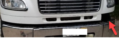

    I have a 2010 M2 Freigtliner with what is referred to as the tall hood. It has about an extra 3 inch piece of trim that is below the grill and has a piece broken out just below the headlight, other than that the hood is in good shape. From my research it looks like the only fix is to replace the entire hood. I checked it out and it appears that when they were originally built they take a short hood and glue the extra trim piece on to it to make the tall hood, which originally lead me to believe it was replaceable. Not wanting to change out an entire hood just for a small missing piece does anyone have any alternative ideas on a fix for this? I attached a picture of the damage I am talking about. hood.jpg

    It would be too easy - if you happened to have that piece?
    I'm sure IF it got knocked out on the move, U ran over it.
    Have you thought about re-creating it in fiberglass?
    You have the hood radius above to copy on a cardboard template.
    Cut it on that line and make a form from 3/4" plywood.
    Take a strip that height, and keep cutting it vertically from the back
    to weaken the structure to bend it. Screw it down from the back.
    Grind the top edge of the plywood form to have glass matting
    go over plywood thickness edge - for the lip to fasten it to.
    Slop resin on it, let dry, do it 2 more times, and there's your piece.
    Cut broken edge straight and measure and match yours w/other side. sand it out smooth and piss paint on it.
    A Saturday afternoon and a case of beer outta do it!
    Total cost less than 100 bucks; not 1500.00 for a hood.
    And That's exactly what they did, just added that piece.

    Thanks for the info...I asked a scrap yard place I found on the internet about it and the guy I talked to said they could actually get just the lower piece from Titan hoods out of mexico, for fairly reasonable price. The shipping will be as much as the price of the part. The guy I talked to stated that what I said about the MFG just making a stock hood and gluing the lower piece on it if for the tall hood is accurate. I will keep you posted on how it plays out......being Friday it is just about beer 30

    UPDATE--I got pictures of what they call the "apron" from C&H truck parts and they do in fact have them. I ordered it so in a week or two I should be able to start on replacing it.

    2
