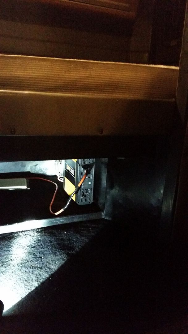

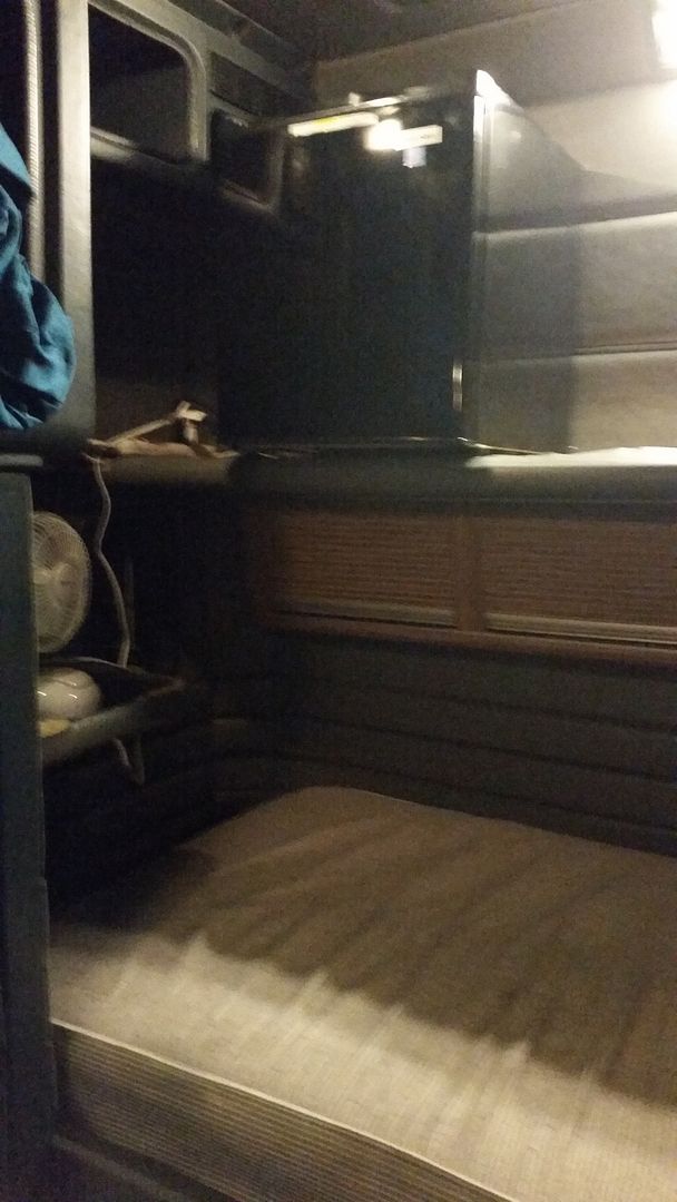

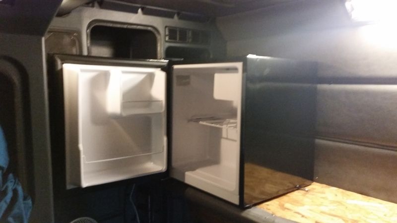

    Well, I got my fridge setup done. I can snap a picture of it if you guys want. I took off the front half of the top bunk in the sleeper. I got the little 1.5 csu ft. Fridge from menards for $70. I had like $80 on an in store credit, so I figured what's to loose? I routed an extension cord from the top of that to under the bottom bed. Under there I mounted a $150 2000 watt power inverter. So, I mounted the fridge and a small power strip up there, and with a small fan and the mini fridge, it only pulls 80 watts. I had it on for about 4 hours and didn't move the battery power at all. The fridge is dead quiet, and the fan from the power inverter has a hum that makes for a decent white noise. Should work nicely!

    Got a pic of it in the truck?

    I'm going to get a matching piece of grey vinyl to cover the top of the half bunk. Then I'm going to get a 90 degree strip of aluminum and screw it down from the fridge to the drivers side on the front edge of the half bunk. That way we can put things up there and they won't slide off.
