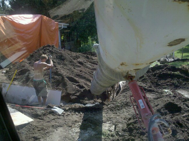

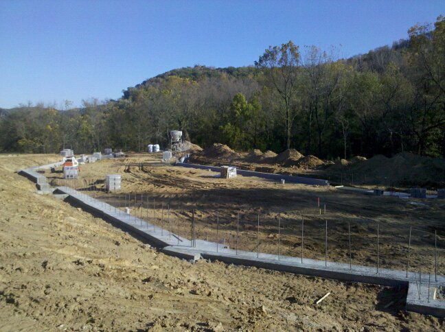

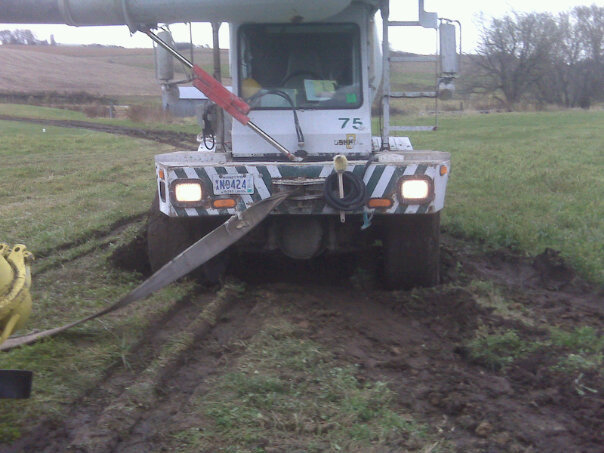

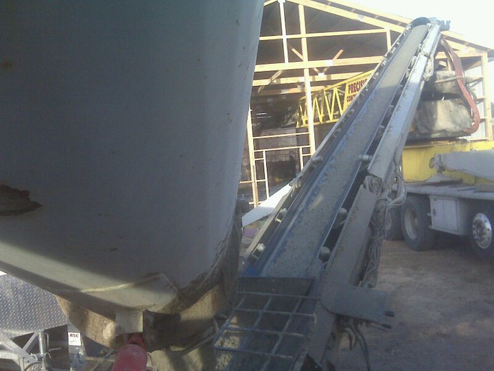

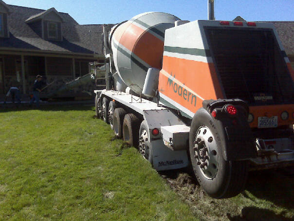

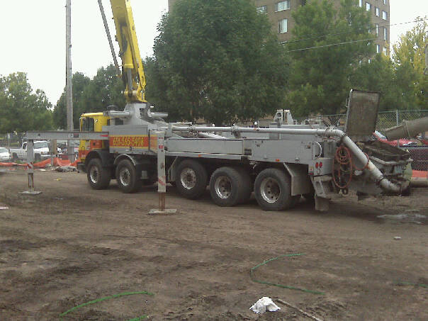

    You have an air ride seat, automatic 6 speed trans, air brakes. Let me see if I can find my pics of the inside of my mixer. Well I found one pic of the lock up system to put it in 6X6 and low range, one of our pump, a couple shots showing the footings at some job sites, and a couple of trucks that are buried. Don't think anyone mentioned this, but you will get stuck at some point going off road because like someone already said usually we are the first ones into the site to pour the footings and the ground is crazy soft.
