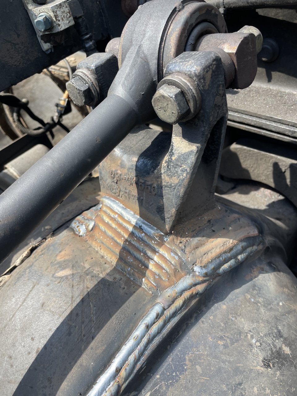

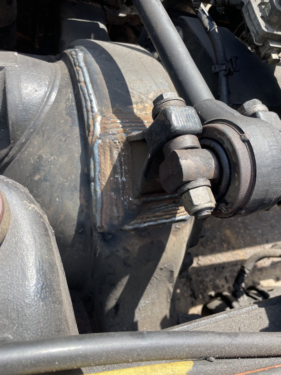

    Who ever welded this, did an extremely chincy job. Truck has a peterbilt airtrak suspension. Evidently there’s been some troubles in this area before. I’m a pretty competent welder and this job can be done with thorough cleaning and prep, a 7018 rod or a mig welder, with good heat. Should I remove the torsion bar when welding or leave it with or without suspension aired up? IMG_7020.jpeg IMG_7021.jpeg

    Probably requires high nickle electrodes and pre/post heat. I would be seeking out welding repair process information from the manufacturer of the axle before just laying down some 7018 and hoping it sticks because that's probably what the last guy did by the looks of it.
    Definitely beyond the skill of the average backyard DIY'er IMO.

    Do you thank all that gobbing was done at one time? I doubt it. Then my concern is the structure is compromised, spider webbed, and would keep coming back like it probably has. Then gobbed and recobbed. It is hard to repair structure with welding. I would remove the the bracket and grind it flat. Weld the bad spots and grind it flat. Put a slight amount of air in the vent fitting and spray soapy water on the area. Keep at it until there are no bubbles. Then make a plate a little larger than damaged area and weld it up. Then weld the bracket back on. JMO.

    The ole grinder is gonna remove all the bird turds, just so I can see what kinda crack(ing) I’m up against. Fortunately it’s just stamped steel and as long as it’s clean(and that’s probably the most critical aspect) it will weld up fine. Worst case, as you stated, remove the bracket put a good piece of steel under it, weld it, then weld the bracket. I’m seeing some possible gussets used as well.
