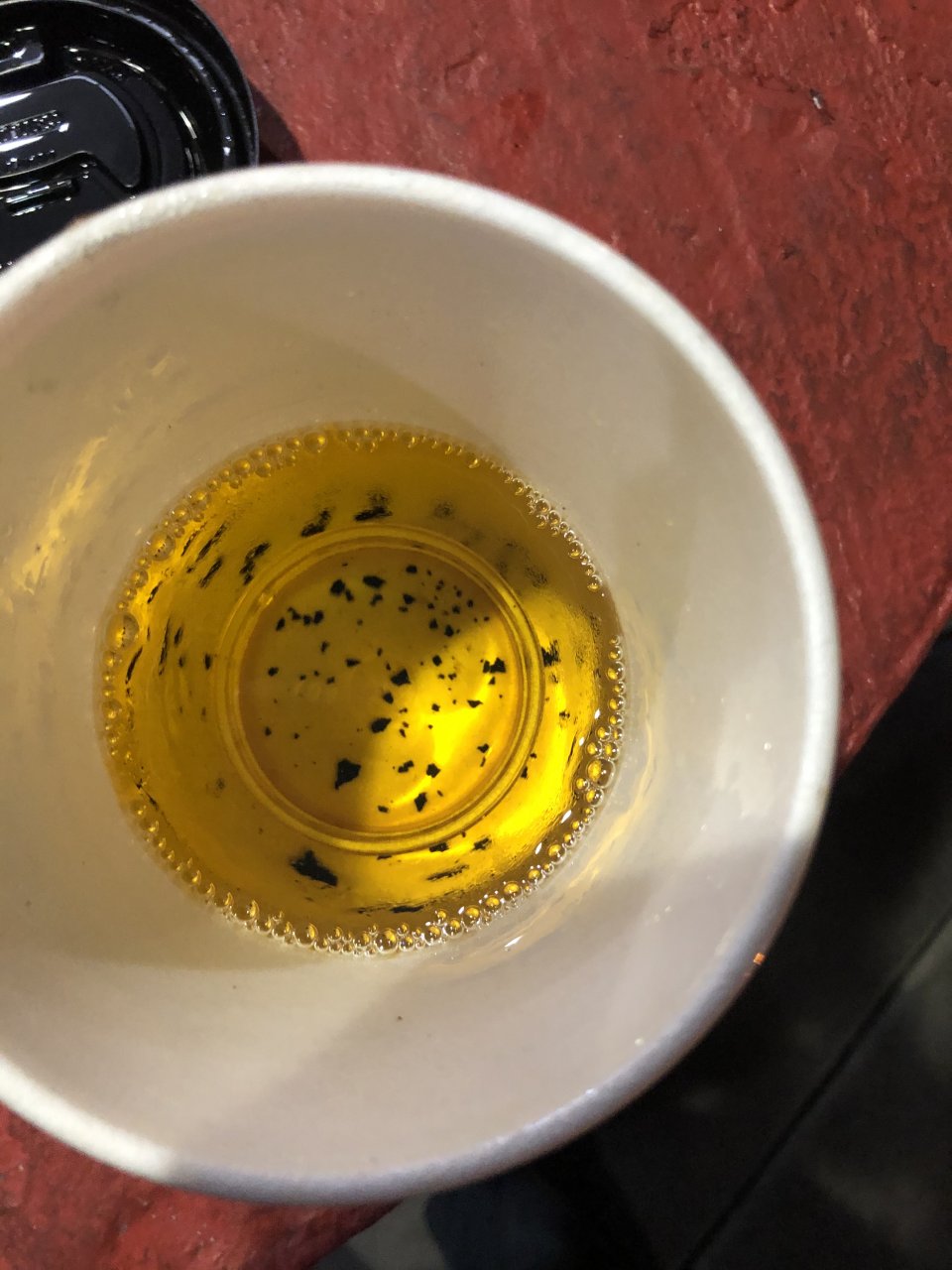

    88898102-CED1-452F-889C-7AC16335BF98.jpeg Here’s what I drained from filter

    is it hardish black pieces. if so my money is on fuel lines from tanks. the 14l 60 series detroit's in freightliners are known for that too.

    The lines that go into the tanks themselves or inside my tanks

    tank to fuel pump. check the rubber/metal braided hoses
