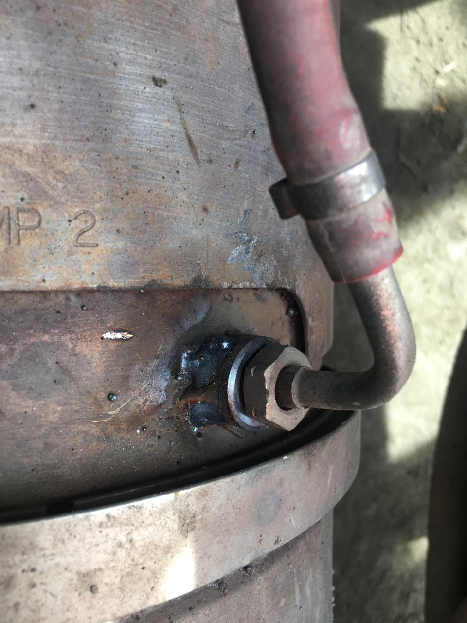

    I fixed the dpf port by grinding off the chunks of broken thread from the old mount that cracked till it was flat and smooth.
    Took a piece of short pipe with female threads and put 3 good spot welds on it where the broked threads were.
    Screwed in the sensor and we were good to go.

    Heres a pick of the fixed bung

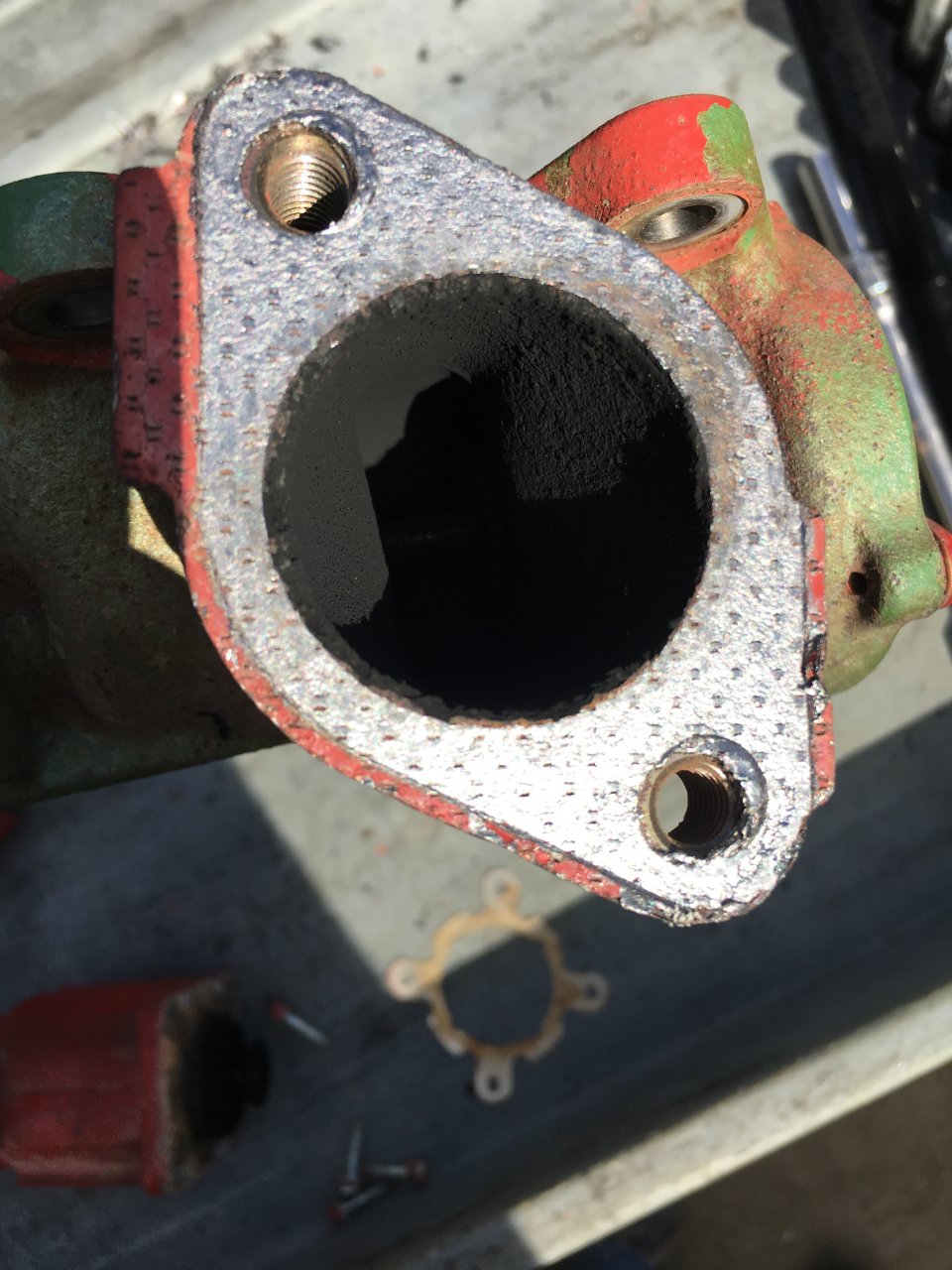

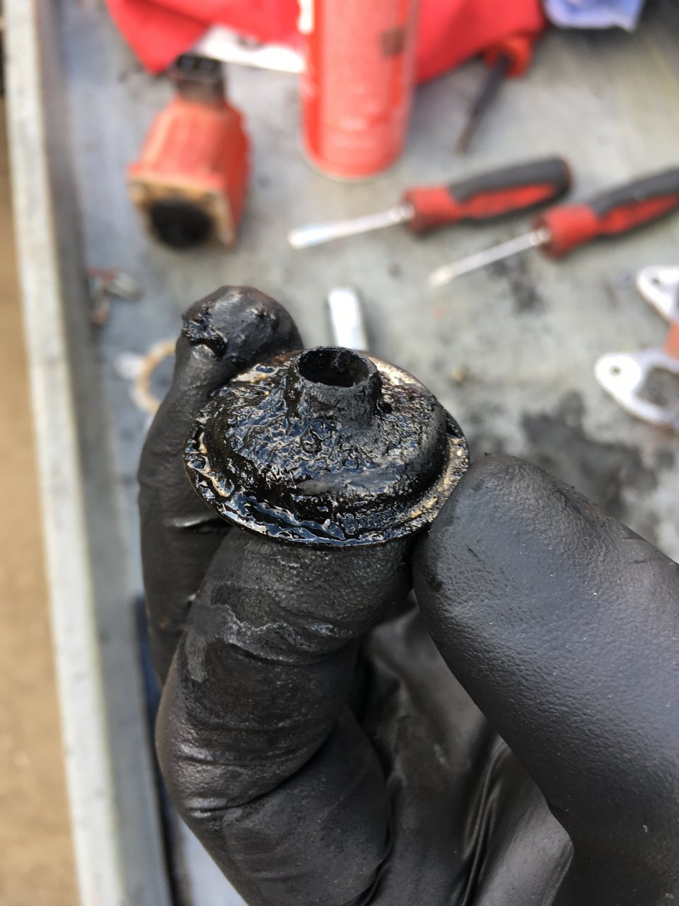

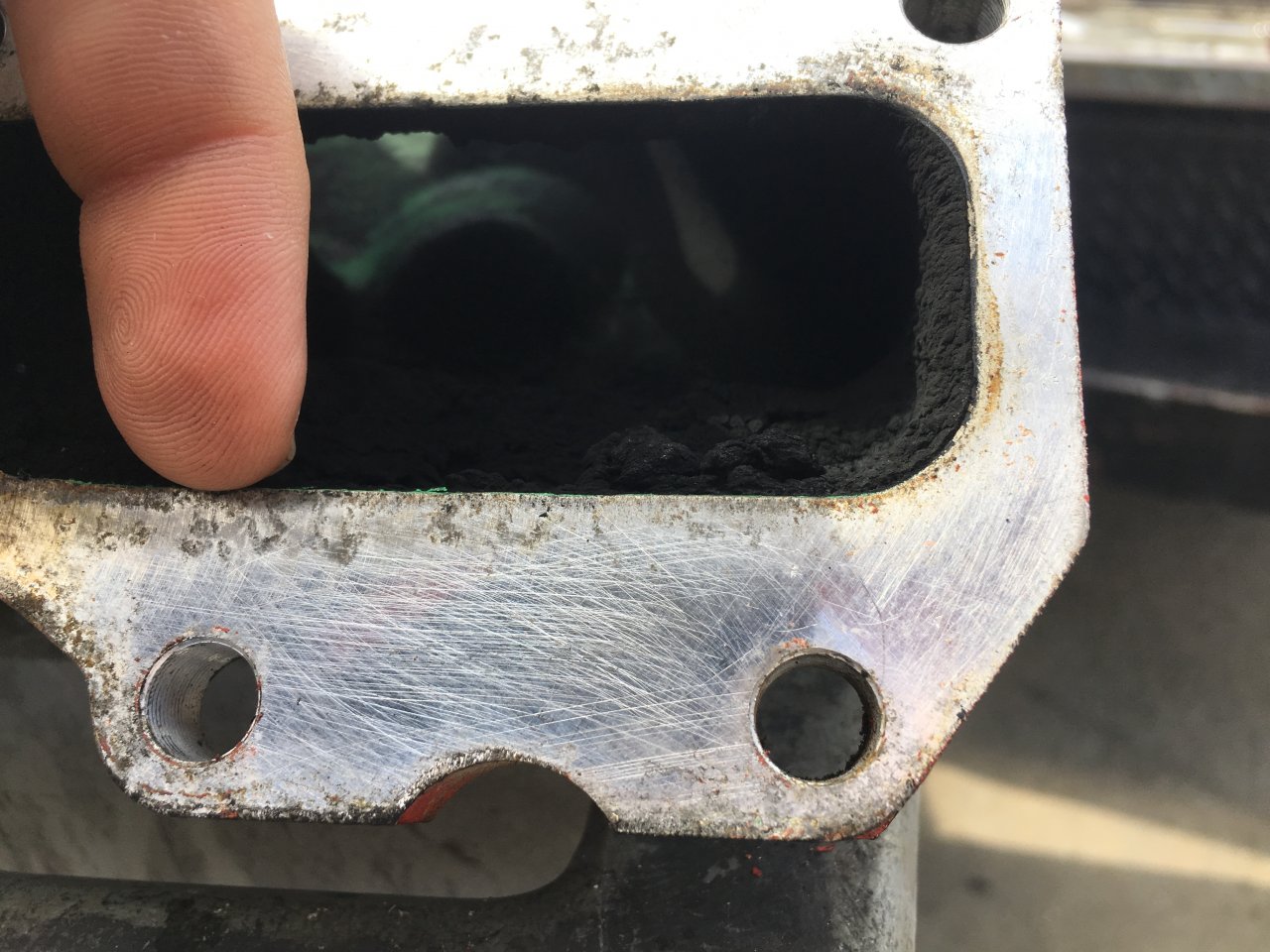

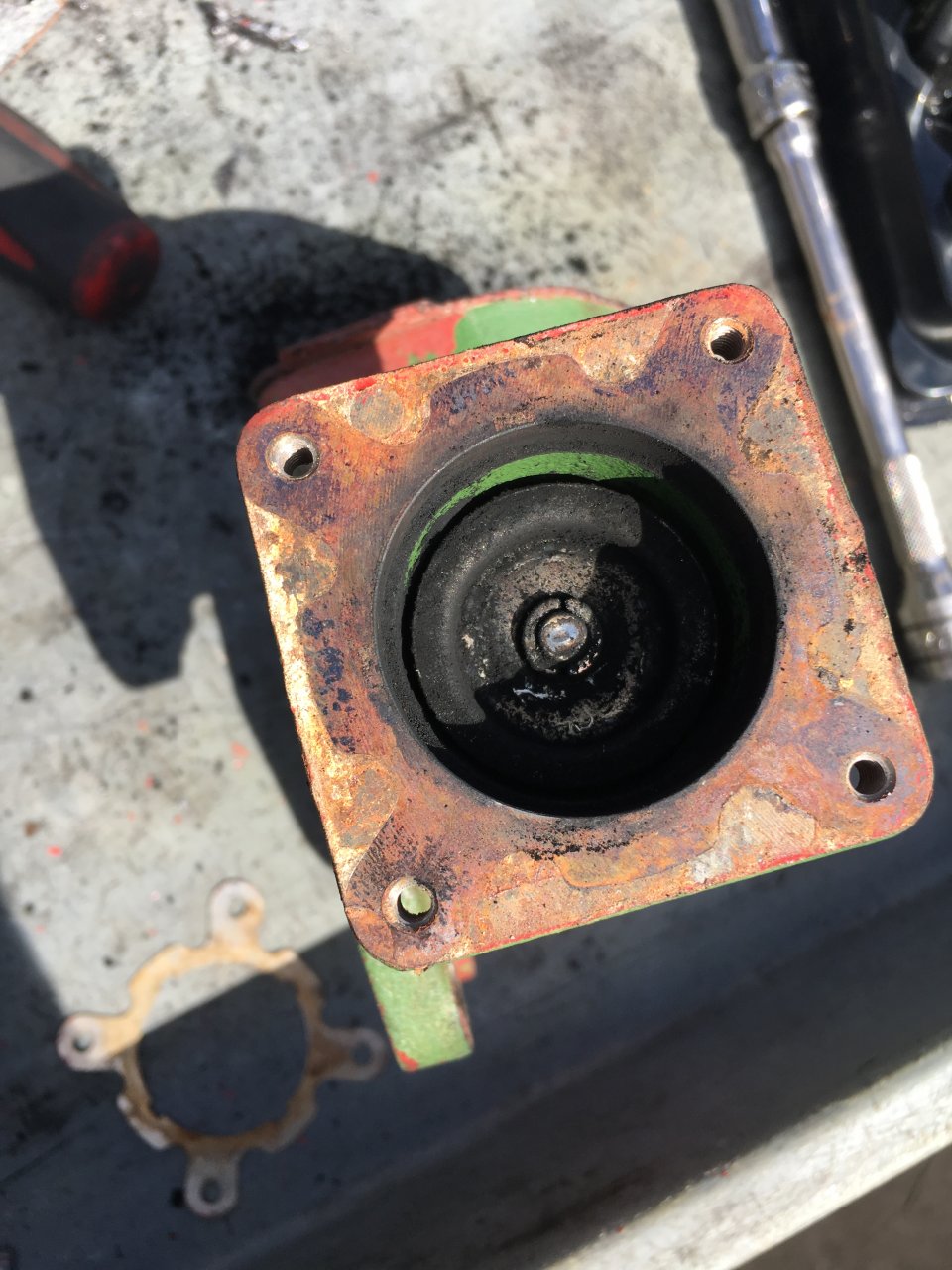

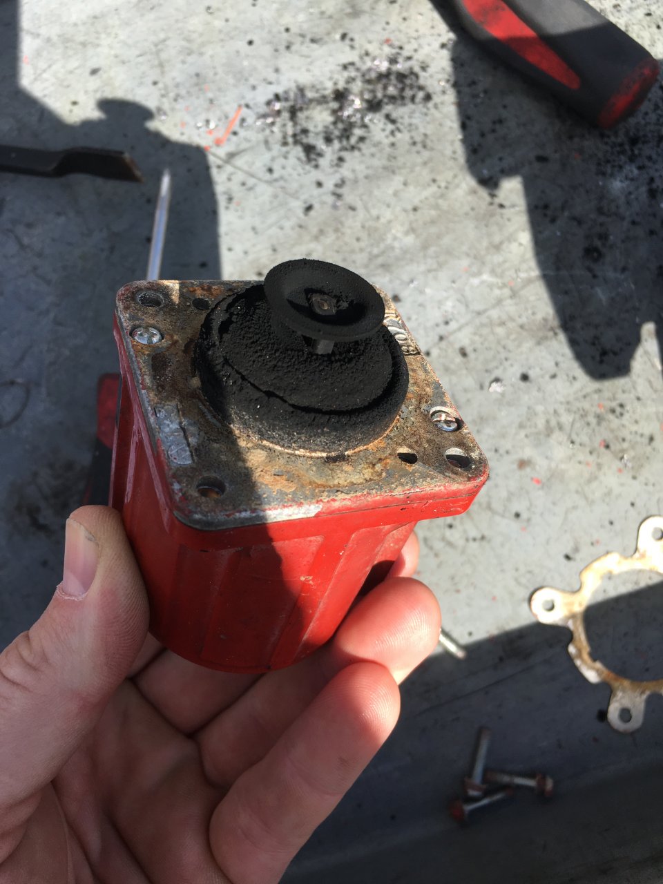

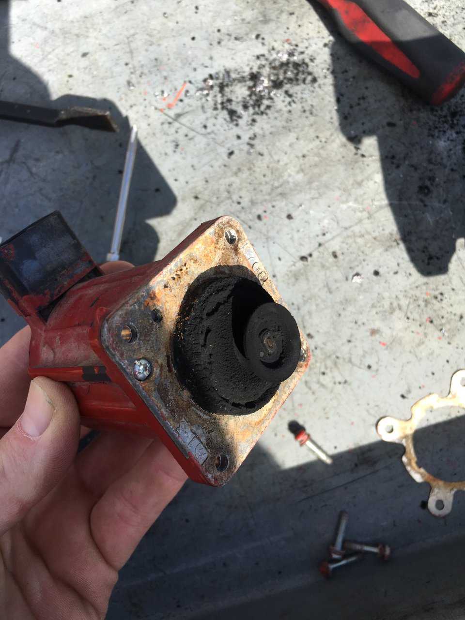

    84E954DB-F5FD-4841-BFBC-60D90A570A66.jpeg A67F5783-35C5-4A22-91A6-0F356F65068A.jpeg DAD8EDBC-3900-4297-8AA7-935DF722E205.jpeg 1890C5E9-1F0F-48C8-9CD7-E3020F5A5C75.jpeg 076C3039-DC0F-4B98-9176-93E3013E1A1F.jpeg C16F2507-07E3-407C-AD37-EEDFC464DDA7.jpeg 94CA9E23-7000-47AA-904A-E29050CA52BC.jpeg Remove the exhaust and did the snap excell test, no black smoke whatsoever. Took apart and cleaned the egr valve and air connection that the egr valve connects to. (both were extremly sooted)! Cleaned all orifices out vey well. Couldnt install pressure relief valve ( didnt get the new washer with it, have to order separate). I will report back when we install the pressure relief valve and run the injector performance test. Found a blown exhaust manifold gasket that is starting to screech, going to install new gaskets next weekend. Not sure if that is contributing to my issues.
