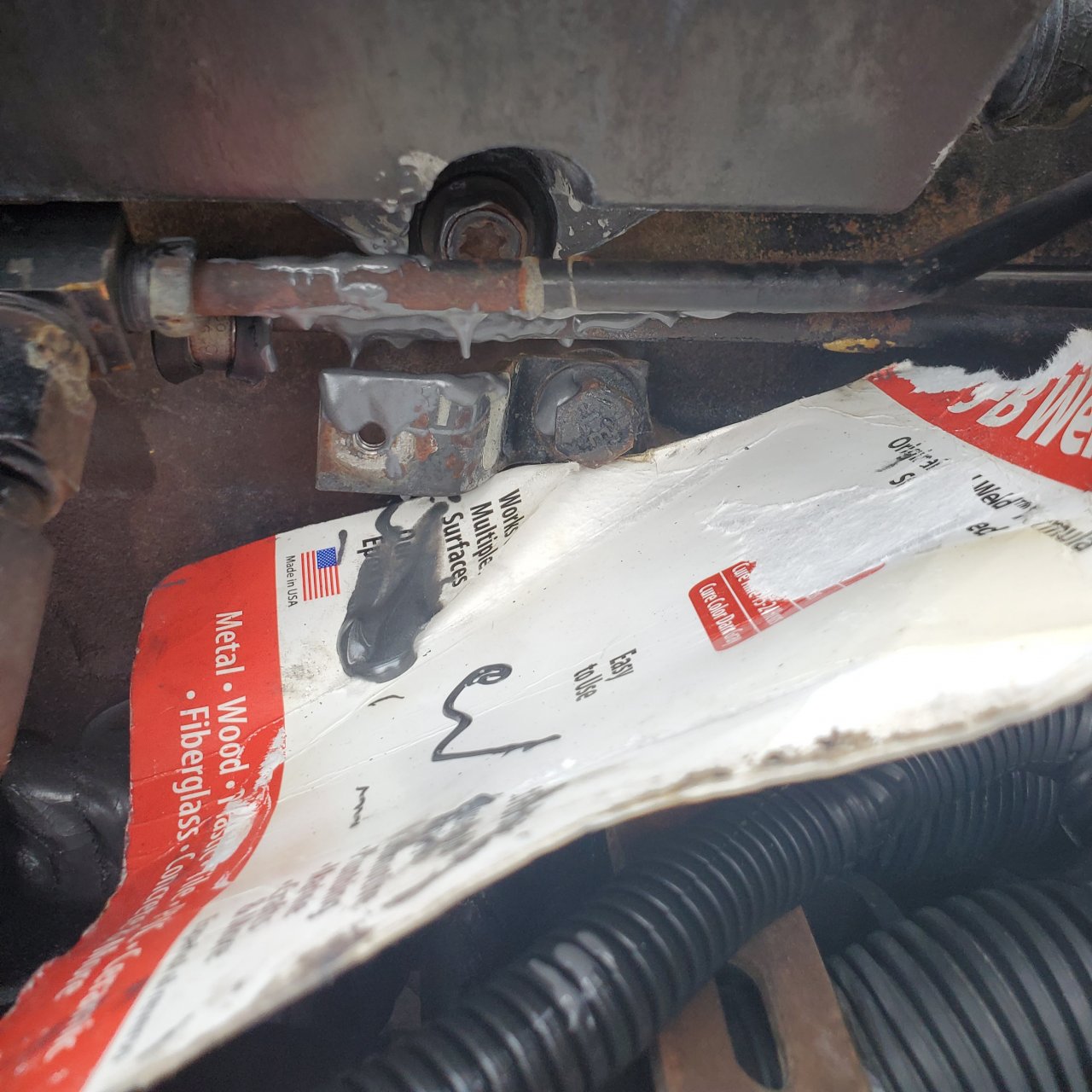

    20210803_002005.jpg l had a leak on my engine and just used JB Weld ...
    Don't know if you're referring to steel lines..
