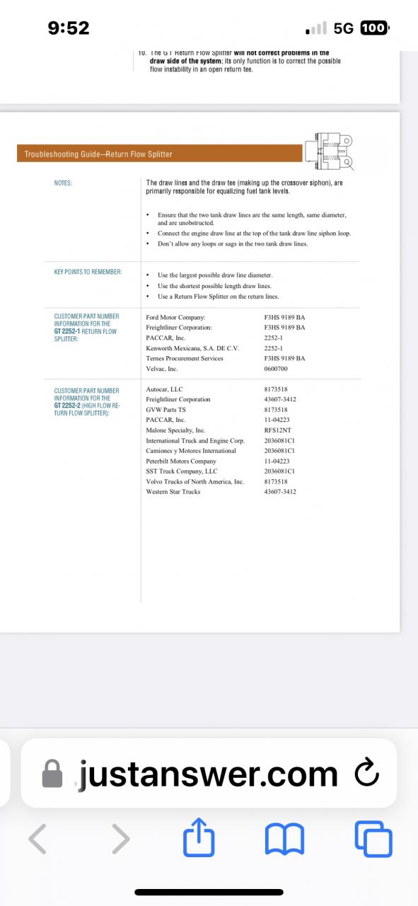

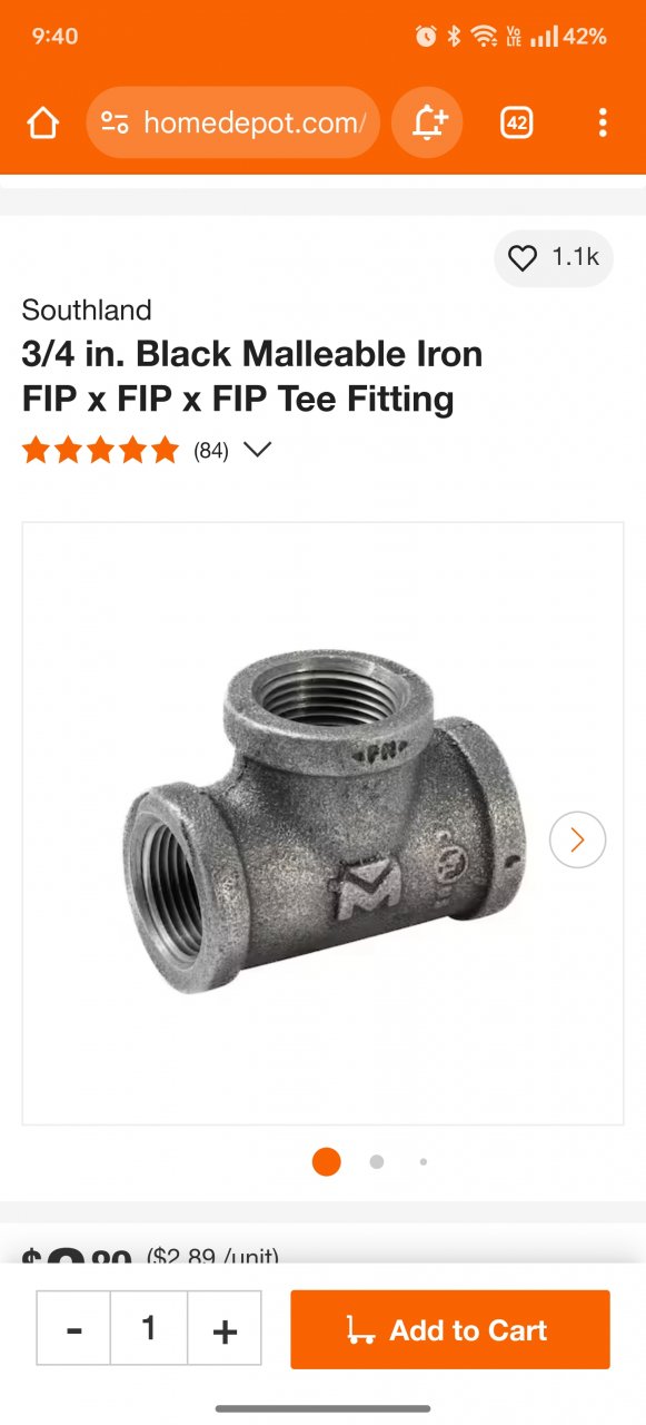

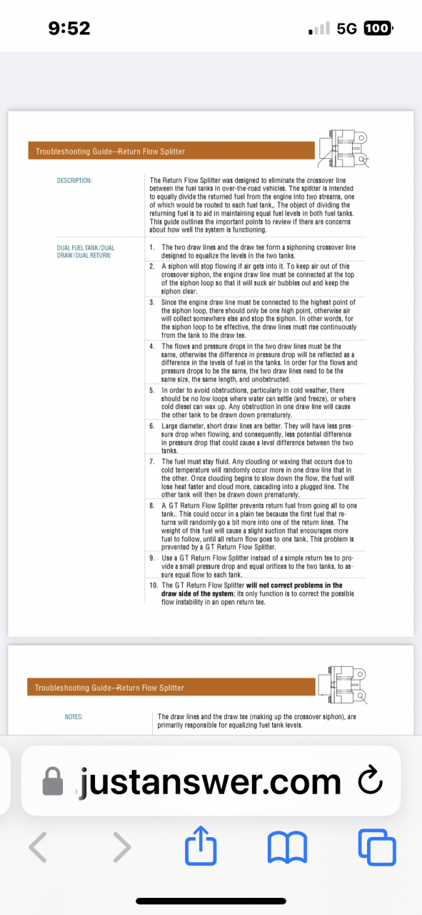

    You'll just need a tee for supply, and a high flow splitter for return.
    I would avoid the balance line myself, though it is likely legal for that truck. Screenshot_20241014_191024_Samsung Internet.jpg

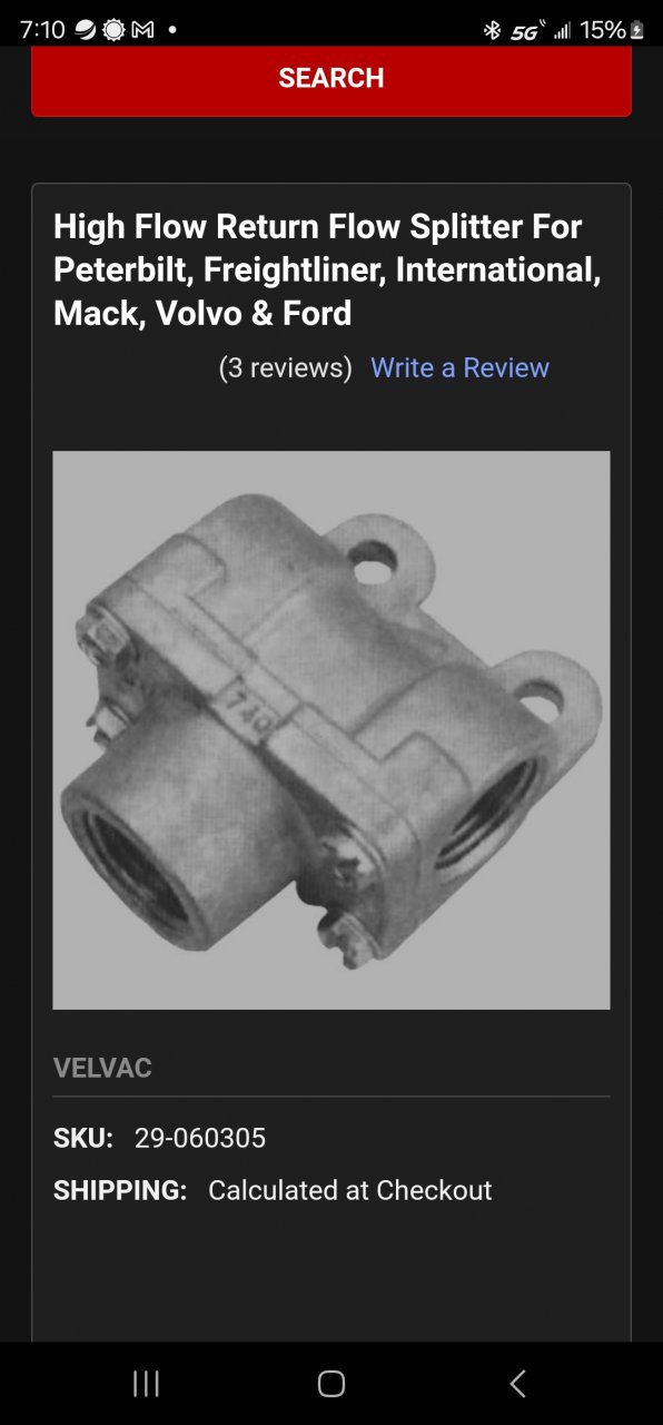

    Plumb the return line from the head to the top port of the splitter, then out each side of the splitter to the return port of the tanks.
    The splitter puts equal return to both tanks when set up correctly.
    The supply will draw equally with a tee, as long as all lines are in good shape, same size, clean vents

    I don't remember the exact size, but I replaced the splitter from your pic with this kind on my truck

    The old mechanicals run better drawing from bottom. The fuel pressure caused by gravity helps them old pumps. The bungs on bottom of tanks were always just 1/2 npt. Tee at left tank to cross over to rh tank with a #10 hose from tanks to filter or pump. That is all you need. Return fuel to lh tank by plumbing to top somewhere. Usually a #8 hose or sometimes depending on pump set up it may have two return hoses. One #8 and #6 to lh tank.
