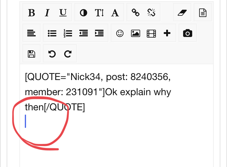

  6. johndeere4020
    8,522
    119,292
    Jan 1, 2010
    Ok, when you hit “reply” type your message after the last line of the post you’re quoting right where the blue line is like this.
