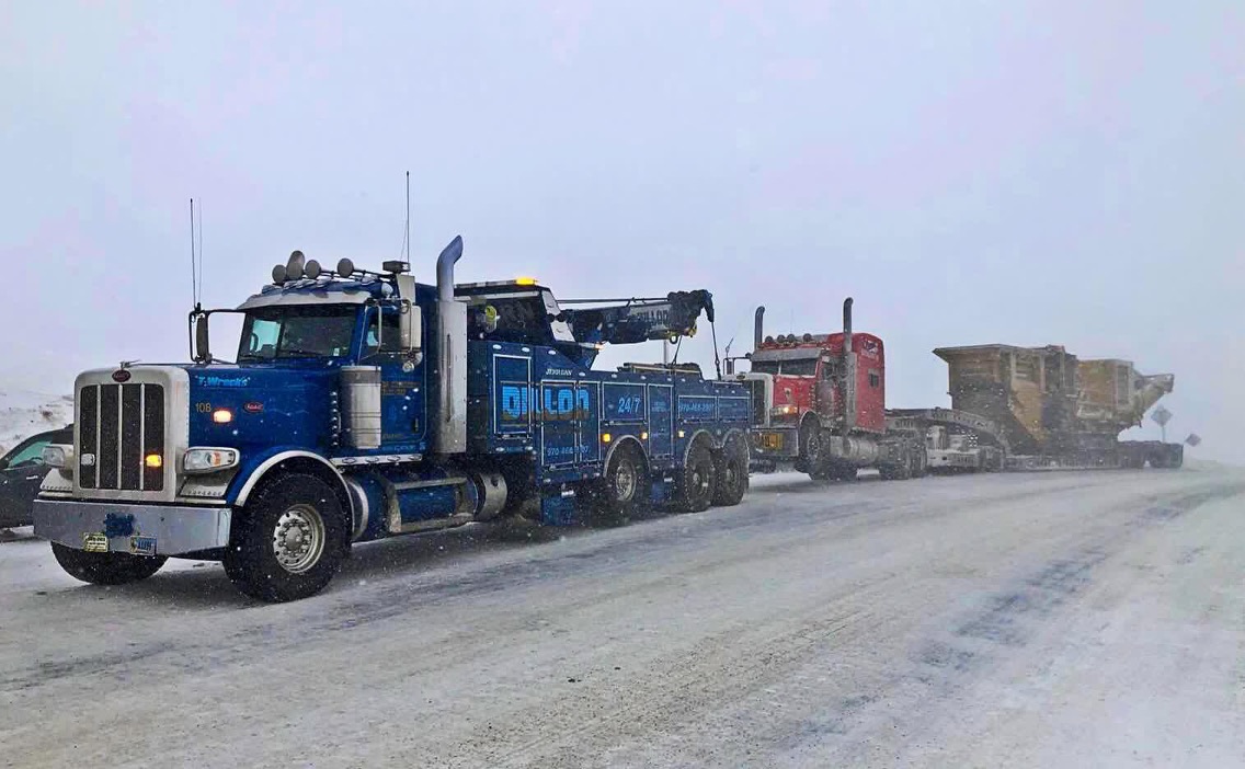

    Wonder if this wrecker is running a direct 10 speed and 2.64 rears; one live axle and one dummy to save on fuel, with a APU to run the wrecker hydraulics, Prolly a Turbo3000D unit as well- man all that fuel money he’s gonna save will be out of this world!

    Yep that guy he's pulling probably went with something stupid like an 18+4 and 4.30s. Gotta get dragged to the fuel stop now when he ran out going up the hill.

    Kevin Rutherford specd that wrecker himself. It was featured on the cover of Green Peace Magazine. Al Gore was explaining how the AirCell intake spacers worked in conjunction with the turbo3000 and air tabs.
    They are using straight tread tires all the way around it to reduce rolling resistance during high wind conditions.
