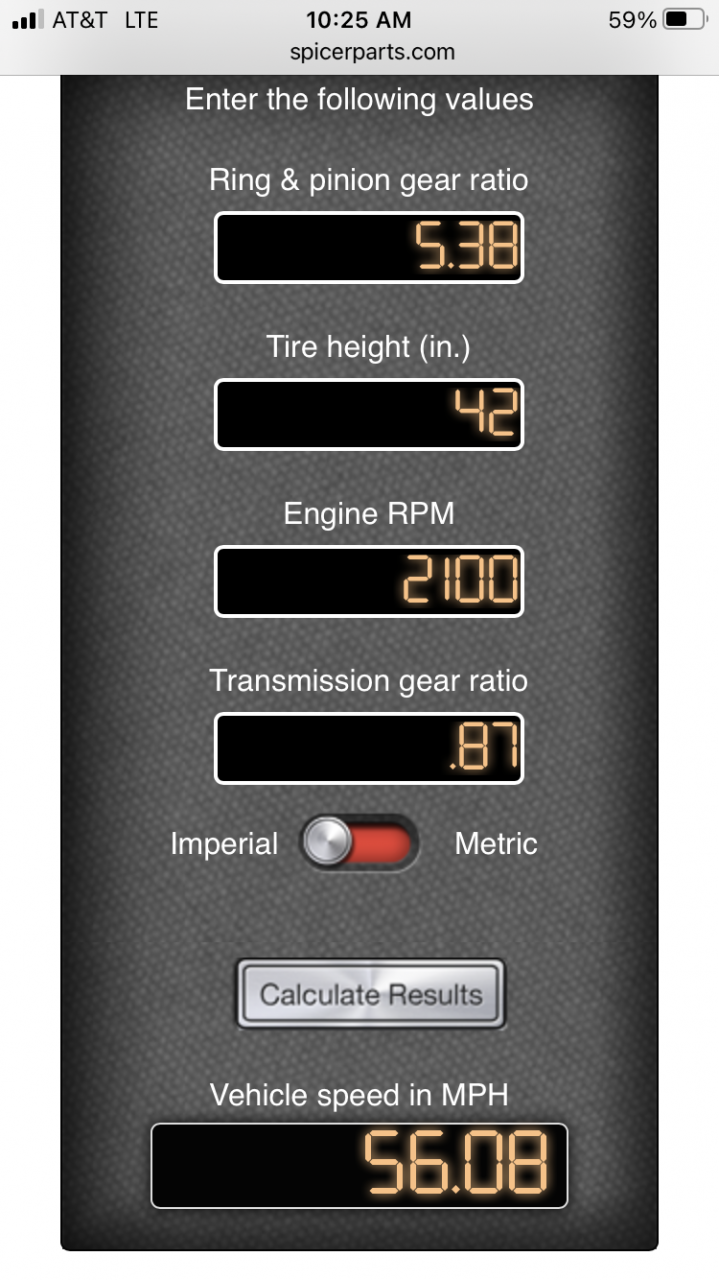

    Think I’ll be coming up a little short in my uncles 76 KW this weekend......
    clearly doing it wrong though because there’s no way the truck must of been able to make money in the last 45 years according to these guys....

    Thats what the Diamond T will do with both knobs in od at the dash. A blistering 56 mph.
    Same rear gear with the 5x3 and 10.00-22’s

    The highlighted part is wrong. It's not the number of great ratios above direct, it's the number of gearsets.
    The RTOO (OO meaning double overdrive) was never referred to as a triple overdrive, even though the top three gears were overdrive ratios. It was called a double overdrive because there was Overdrive in the main box and overdrive in the splitter.
