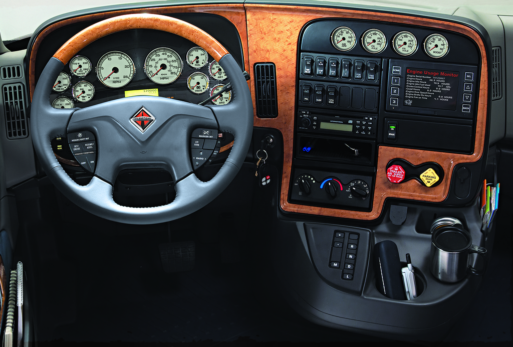

I have Prostar 2009 with cummins ISX and Automatic ultrashift transmission. sometimes on the road when i slow down or stop i get a warning in dashboard with GEN TRANS FLT and the transmission won't shifting is staying on N untill i shut off the engine and start it for few times than will rest it. any idea what is it please.
Thanks
GEN TRANS FLT code... what is mean
