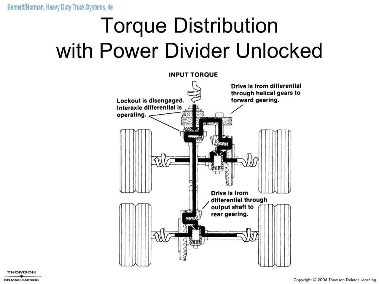

    Just checked mine and it only drives on the rear axel the front axel does has no drive.

    Tell me how you came to this conclusion?

    This is the path of power with the power divider unlocked. This same diagram comes from EATON so if you want to call them up and argue it with them, go right ahead.

  6. swaan

    Thank you Amodelcat.
