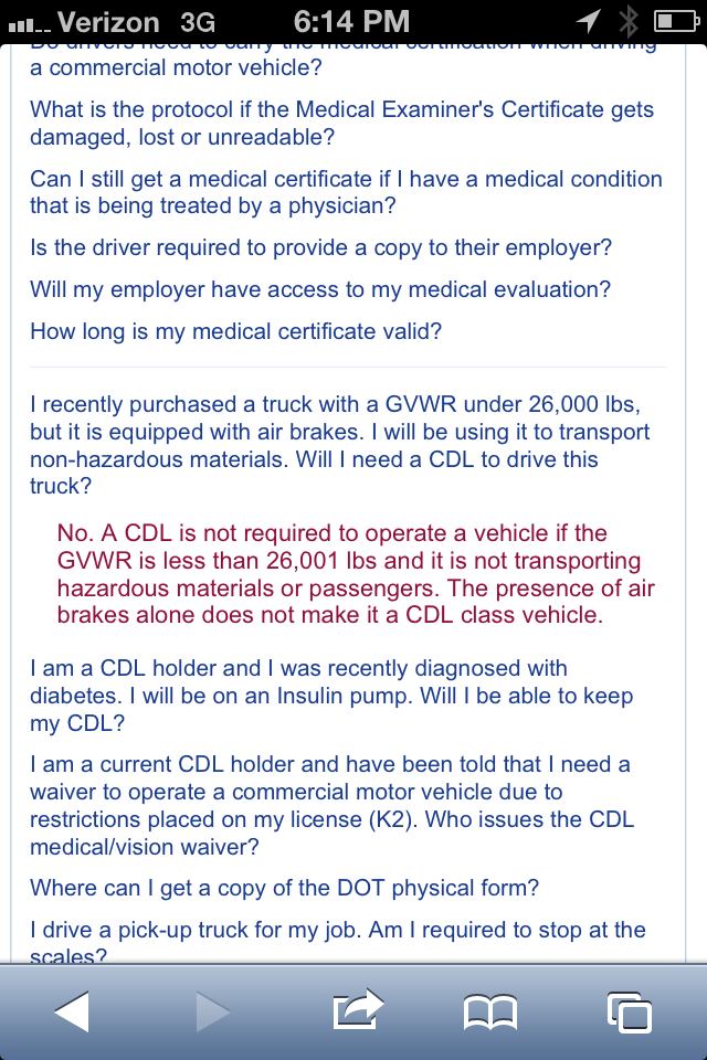

    I know the difference between air an "hydraulic" brakes. Cmv licensing laws are the same for all states. It is infact federal.
    There is no air brake endorsement there is a restriction. Class c cdl is only for vehicles under 26,001 hauling hazmat. If hauling passengers you need if I remember right a class c with the "p" endorsement. Regardless of weight or air brakes. Please don't be giving incorrect info.

    This should clear it up.
