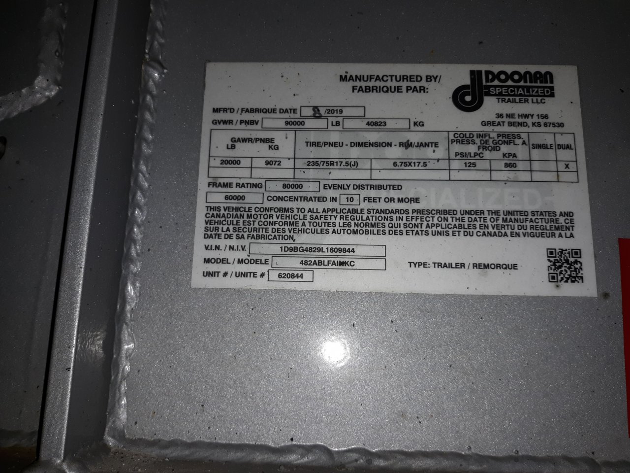

    Not saying the triple wouldn't be better, & easier to load. But my spread is good for 90k gross, 80k distributed, 60k in 10'. Not sure on the actual tare weight, but it's about 10,400lbs with 2 60" boxes full of gear, 2 8' drops, & about 500lbs of ramps & stands..
    My old wagon had a dovetail with flip over ramps, & boy did I miss them today. Thought i was going to melt in the Everglades humidity setting up the 6 piece ramp kit for the 2nd time in 3 hours..
    I can load lower ground clearance now with 16' of ramp, vs. about 10' with the dovetail variety. Everything has a tradeoff..

    I should clarify slightly, LoL. So even know the wagon is good for that weight, I can never get it that heavy running as only a 4 axle rig. :D My tare now is 26,600. I'm thinking same truck as a twin screw would tare about 28klbs, so that would be a great legal payload for a sub 80k lb stepdeck as well.
    One thing I don't like is I'm guessing the hendrickson suspension is only rated for 20k per axle.? It has 23k axles, & 22,700lb worth of rubber per axle. Be nice if the axle were stickered for 22,500-22,700lbs as to take advantage of that when hauling over 80k gross. I looked at the tag on an aluminum Doonan Chaparral II triple, similar to mine. I believe it was 110k lb gross, 70k lbs in 10' or more..
    It's an aluminum frame Doonan, short 8' upper, 40'5" lower. The gooseneck transition is steel. 17.5" tires, 36.5" at the arc, bout 34.5" closer to step, or tail. Apitong deck. I would have got chain pulls had I spec'd it, but I bought it off a lot. Has J plates, & can locks for 2 20's, or a 40'..
