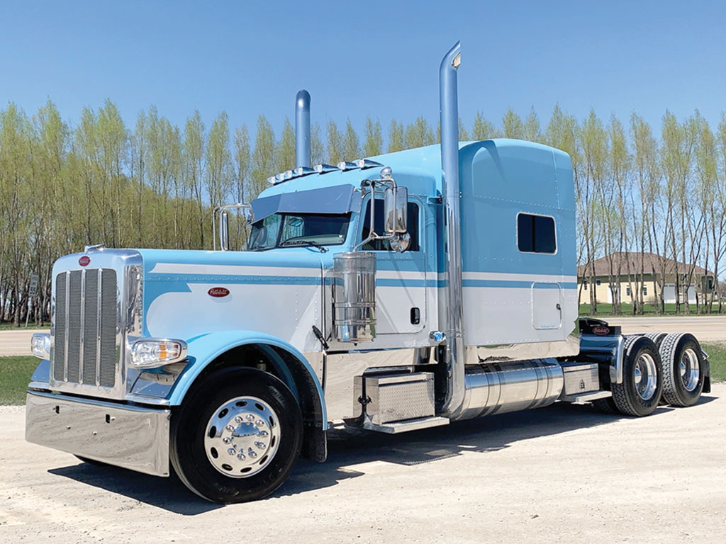

    Just got my Taylor&Martin auction brochure for South Sioux City, Ne. May 16, 2019. This caught my eye, approx 1,000 miles.
    2018 Pete 389, Glider Kit, 80 inch sleeper, Detroit 12.7, 500 HP, 13 speed, 3.36, 22.5 LP and 272 inch WB. Don't know who built it.

  7. m16ty
    m16ty Road Train Member
    2,274
    4,963
    Jan 22, 2016
    That thing should bring a pretty penny, can't say I like the color much though.
