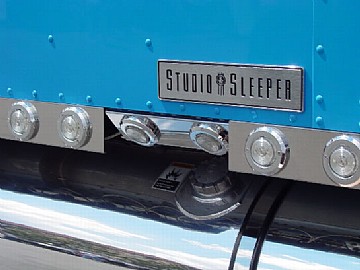

    Honestly your kidding right, where i come from a studio sleeper or aka a condo. Is a double bunk High rise, if ya never seen one before maybe you're blind because they are everywhere.... so excuse me if my terminology is not up to your standards on whatever you say, my truck actually is...

    Nice wow, thats cool.. like i said where im from a studio or aka condo sleeper is a high rise double bunk truck.. i frankly don't care that kenworth calls theres a studio sleeper...
    Love how ya went way off track to what this post was actually about to prove something that isnt even a conversation here...
