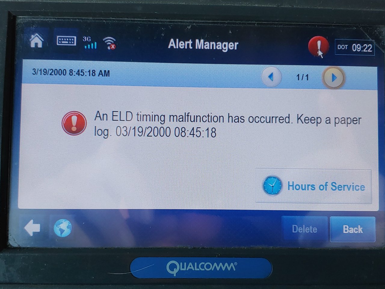

Good to see the new ELD software handled the time change well
Discussion in 'Swift' started by cmarona463, Nov 3, 2019.

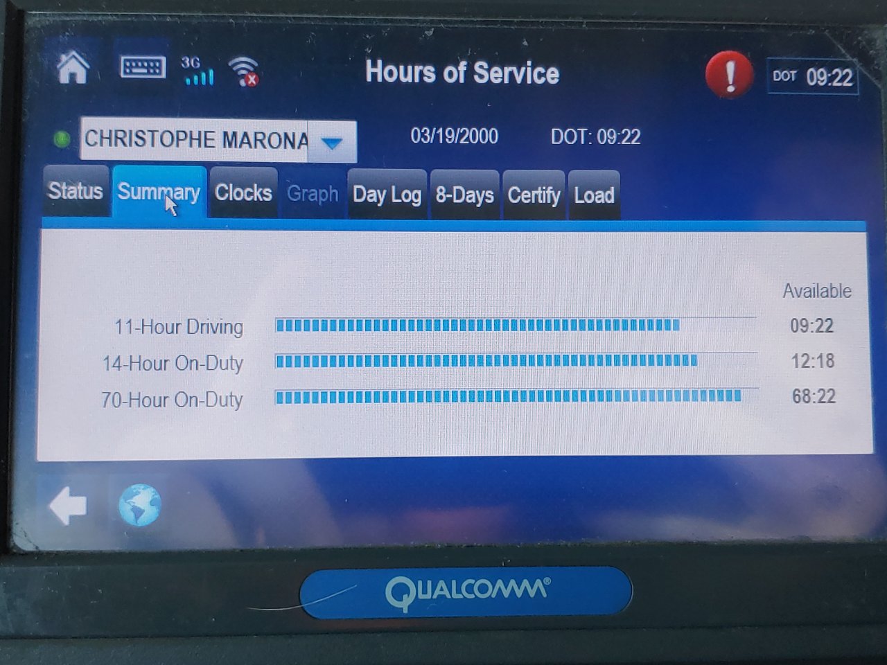

    The issue was Omnitracs trying to update one of their satellites. So it is affecting every Omnitracs unit.

    There is a procedure and number to call Omnitracs tech support to reset the QC, just to make sure it is up to date with the new fixes.
    Log off-duty.
    Go to page two on the QC screen and go to System
    Write down the Unit Address.
    Call 800-541-7490.
    Chose option 1, then option 1 again.
    Enter the Unit Address number.
    It will update your QC unit, and it may take about 20 minutes.
    You will see it shut down and restart, then it should be OK.
