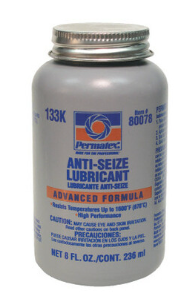

    Just be grateful we dont lube 5th wheels with this stuff...

    If that were the case id be looking like this guy everyday :biggrin_25523:
