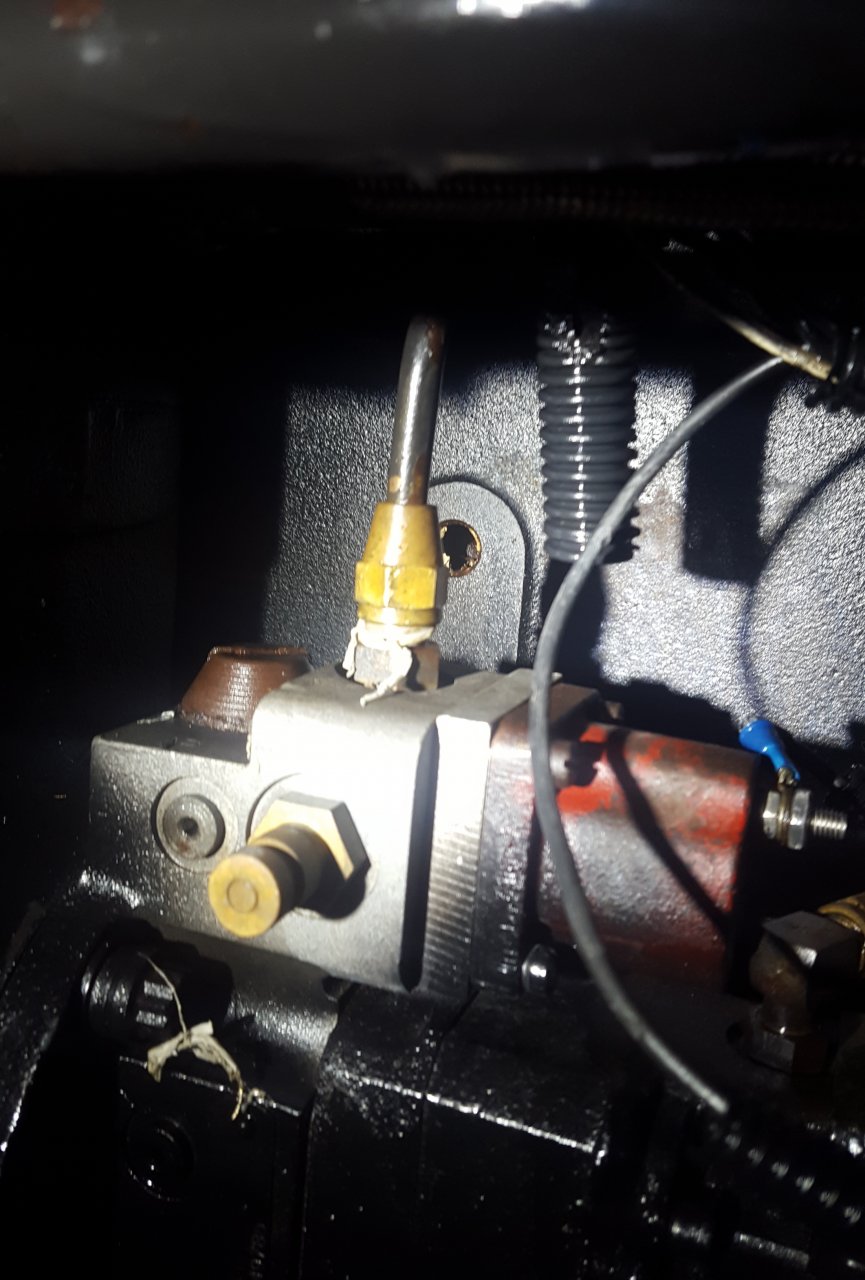

    20210928_224715.jpg 20210928_224738.jpg 20210928_224806.jpg Op
    This has been the only time I got sidelined a busted fuel steel line pulled over saw what the problem was used some brake cleaner and JB-it parked for 10 ..started the engine in the morning and the repair was good enough to get me to the parts house...
    Where they replaced it with a improved version..
