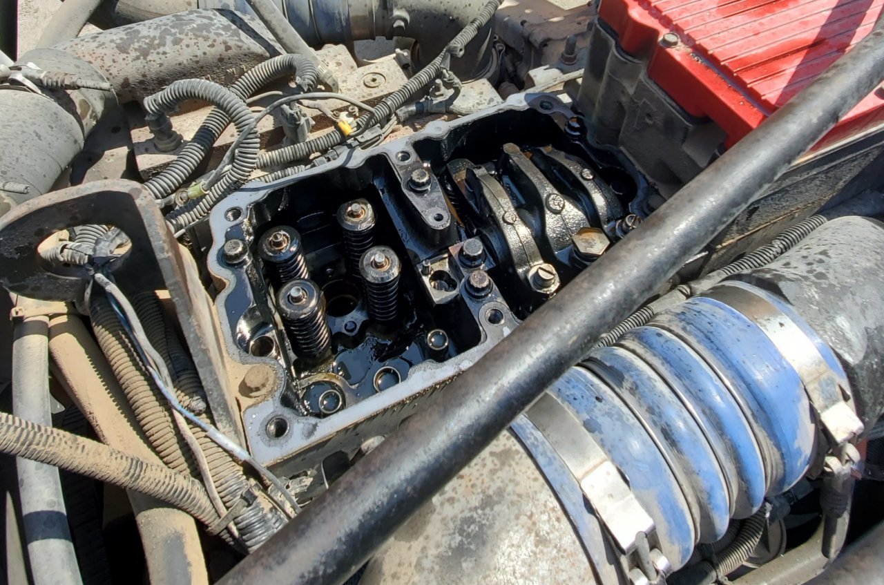

    Swap red for blue, less than ideal, but better than nothing and beats waiting on a road call

    Should do that with every and any truck every PM.

    All I run is old iron, wife asks why I'm under the hood and the truck so much. Easy, it's better to prevent and find problems and fix them here in the shop then on the side of the road. Plus, OOS is not only a PITA, but gives the insurance man an excuse to up your rates...

    Not typically, had a injector go out on my N-14 it did get me home..worked on it half-day the next day..and I was rolling the next..

    Speak of the devil.. I had an injector go out while I was sleeping last night. Detroit ddec iv. Drove it home 250 some miles. Shop says they will have a new one Monday or Tuesday. Had to give back a load 2 hours before it picked up this morning lol...

    I keep one under the bunk, anyone that owns a n14 at this point has an injector starting to go, whether they know it or not

    Blew an air to air boot other day. Since I had one no big deal
