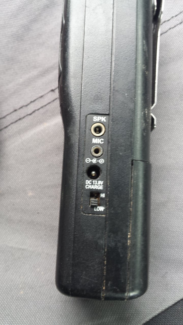

    A Baofeng dual band handheld will cost less than $50.
    I actually have a Kenwood TK280 VHF Radio with me in the Truck.
    Many of these older Moto/Kenwood VHF Radios can be had for relatively little $ as well, since a lot of cities are switching to newer systems.
    Most will require to be connected to a Computer to program though. Could be a deal breaker for him.
    As far as being setup for him. I wouldn't get a Radio that I can't program myself.
    I would look at a Cheap Chinese Radio some are even dual band.
    My newest Toy.
    http://s12.postimg.org/kjdt0tnod/20160210_144527.jpg
