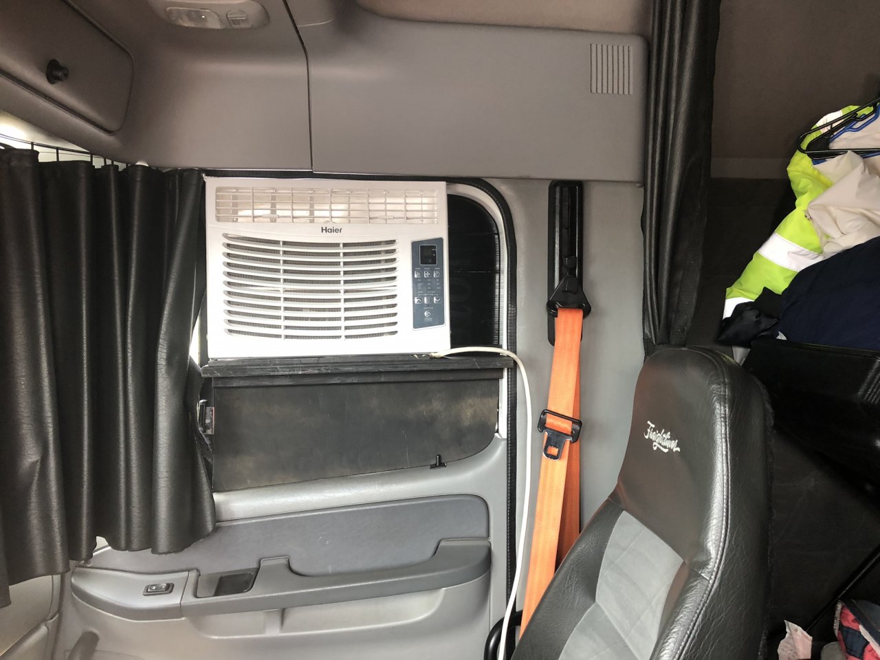

    The air conditioner is a window unit so the hot air is vented out the back like it would be in a house/ residential application.

    I have a stand up unit. I put a hole in the floor with a dryer vent cover. Hose is permanently attached to it with insulated hose. Been this way for 3 years no problem. Works perfectly %95 of the time. On the hottest nights of the year I just idle. Maybe 3 nights a year? But I run Midwest mostly.

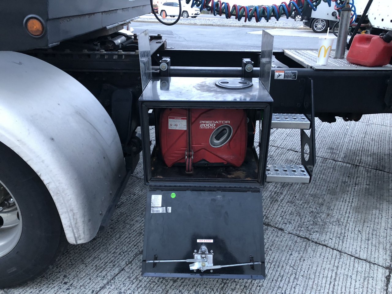

    What about directing the exhaust pipe under the truck to the rear drive axle, or maybe right under the truck frame all the way to the back.

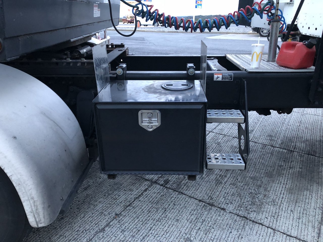

    I just got this last November, very quite

    I wouldn't want it at ground level simply because if the air is still, the fumes hang around. Small gas engines like that put out a metric #### ton of CO—like 1200 ppm. You never know when someone will park next to you with their windows open, or their air intake is too close to your exhaust.
