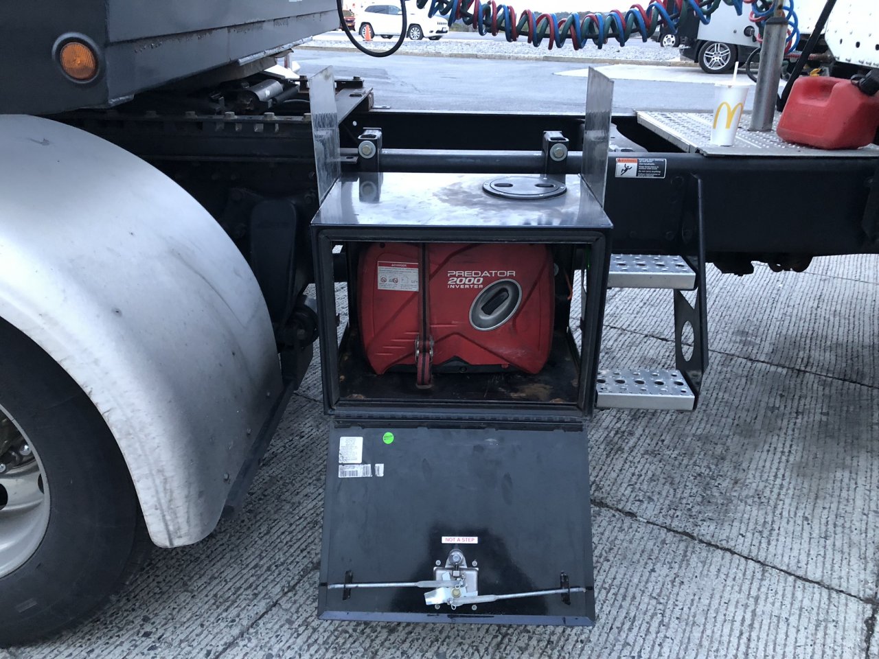

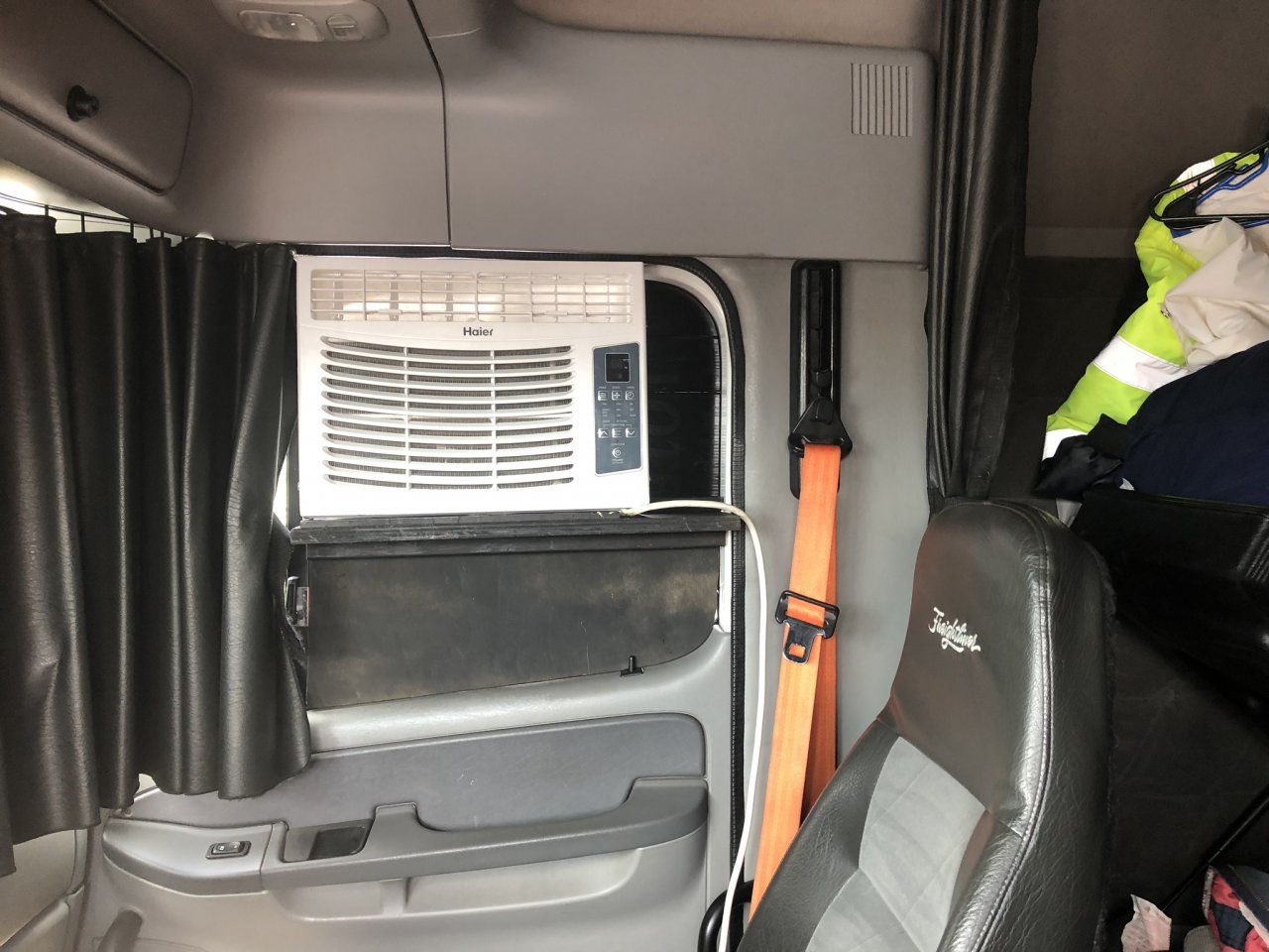

  10. Hulld
    Hulld Road Train Member
    2,884
    6,567
    Oct 19, 2015
    Upstate NY
    25E22D29-7F0A-4DEF-AAF9-7026A6BF1A5C.jpeg 46D28BE9-43F7-463C-A831-068B0CE8B159.jpeg 02935090-9074-42D5-B436-D76A2DB7082E.jpeg 53969EB1-50F2-4E4C-A89E-9B3A4D88FE3D.jpeg B71CBD6A-56B7-4656-AED6-7AF1517D9253.jpeg
    Here’s my set up using the same generator.
    Runs all night on one tank of gas on echo.
    I am using it right now as I write this.
    I’m in Florida and it’s 83 degrees and I’m cool and comfy at 68 degrees in my cab.
