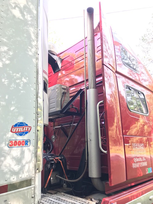

    I had same idea only with an elbow at top.

    I did have an elbow at the top but then it was causing the fumes to blow on any truck next to me. I didn't want to take a chance that somebody next to me would have their upper bunk window open.

    We slept with vents open a while back, meanwhile a Truck parked next to us. It smelled so bad, like the apu was running on propane. I ran my 2200 w generator on catwalk, never noticed it, but probably not a good idea . I like your set up, good idea. I bet it’s quieter too.

    It is super quiet. In fact, it's so quiet that I've forgot about it, left it running and then took off down the road. I lost my cover yesterday, lol.
    A couple of different times, my carbon monoxide detector went off before I put the exhaust pipe on it. I didn't realize there are vent holes on a Volvo, all under the edges of the sleeper. So any time the wind would blow the wrong way, I'd wake up to "BEEEEEEEEEEEP!!! WARNING, CARBON MONOXIDE!" It got as high as 250ppm in the sleeper in just a few minutes one time.

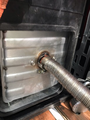

    Napa sells 1" flexible exhaust tubing for like $1.40 a foot or something. That's what I have on mine.
