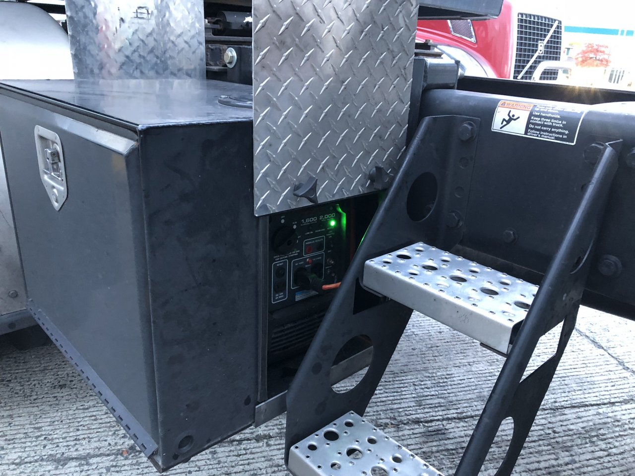

    Yeah I have to do something with it. I have and under frame exhaust. You can smell slightly in the cab some times.

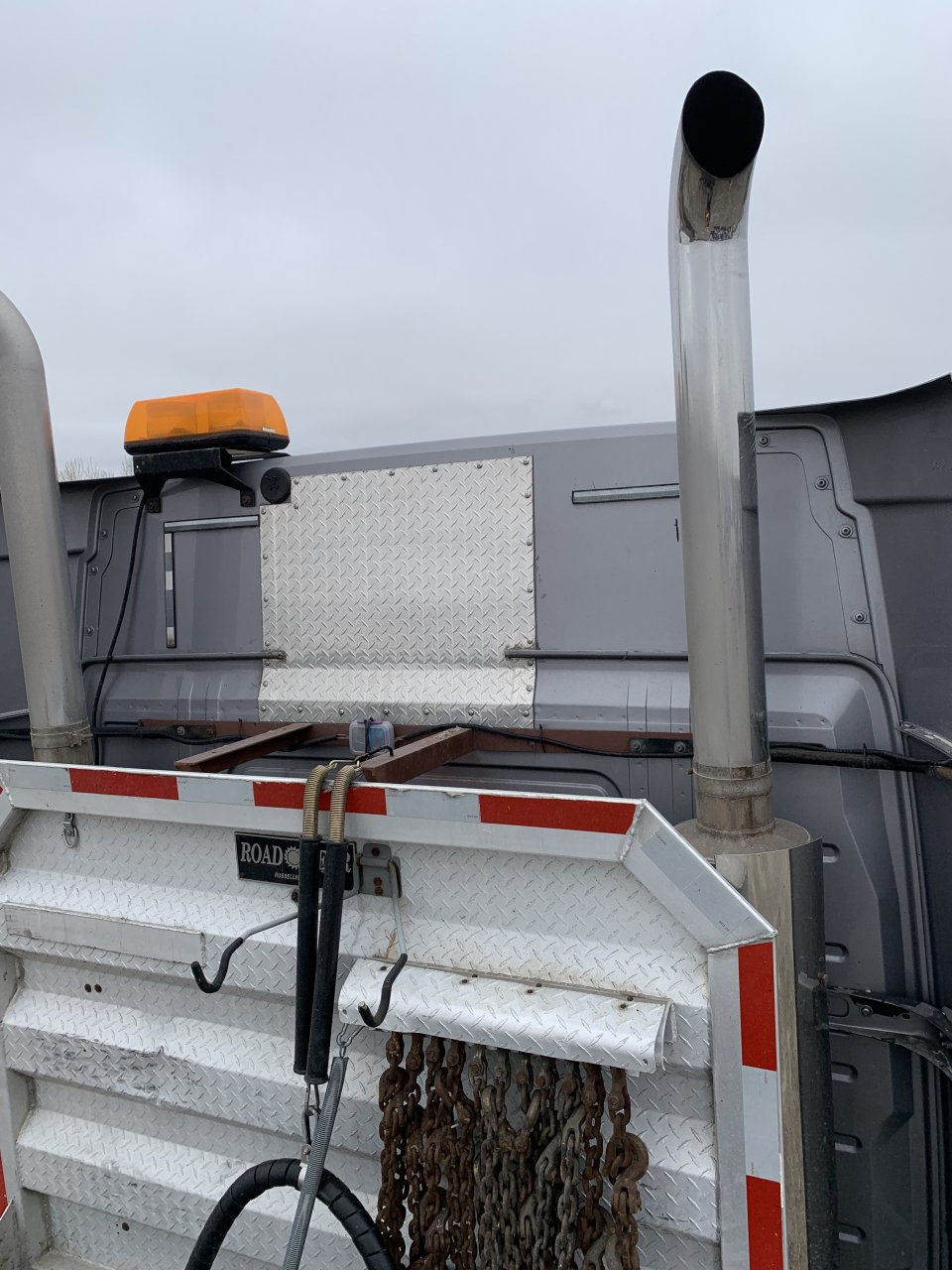

    Ten4. Yeah the only thing is, last year I cut a big hole in the back of the cab to try out a big ol household window a/c. So since then luckily I knew someone good enough to help me bend up some new aluminum and rivet it to the cab to make it sealed again. (Had to take the ac out, was leaking water) So now it doesn’t leak water but was concerned with routing the exhaust that way cause the stacks are only a couple foot above the cut/cab top and was unsure if the CO would make its way in somehow

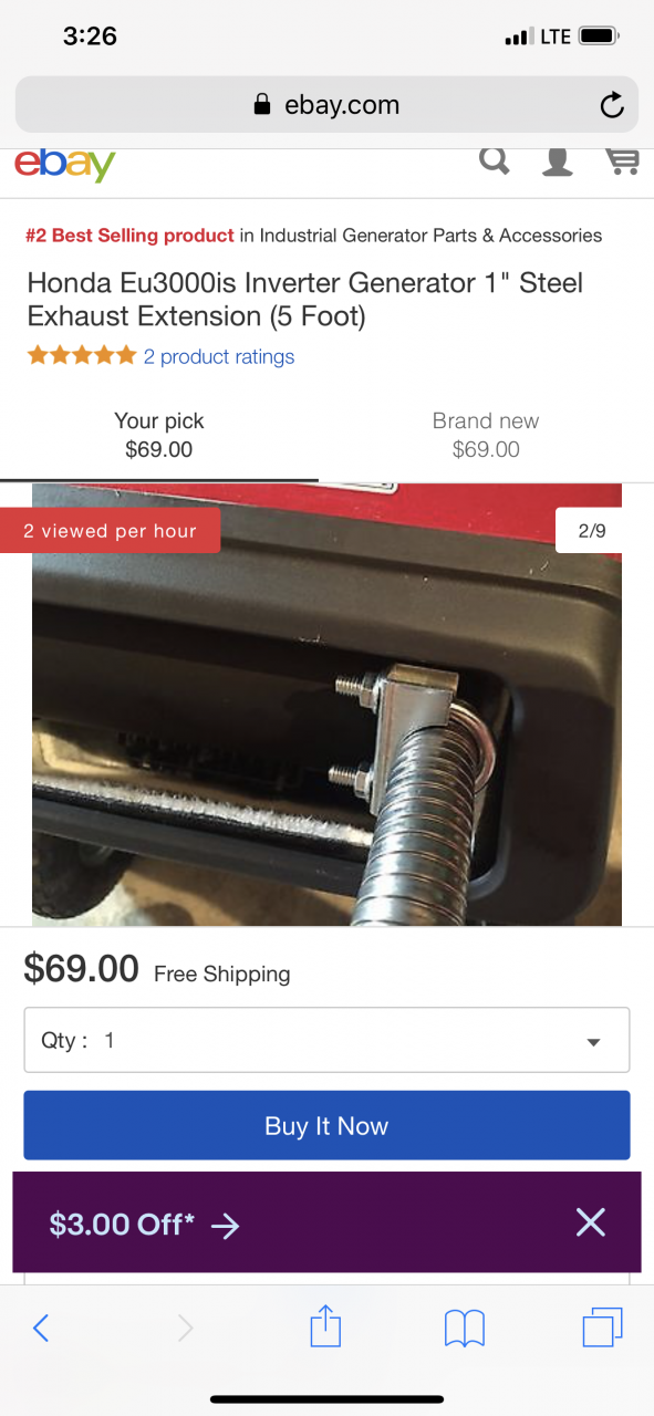

    Use an espar pipe—it's solid stainless with no joints like regular flex. Then use Ultra Copper on each end of that to seal to the muffler stub and the conduit. The only exhaust that'll get out is way high in the air.

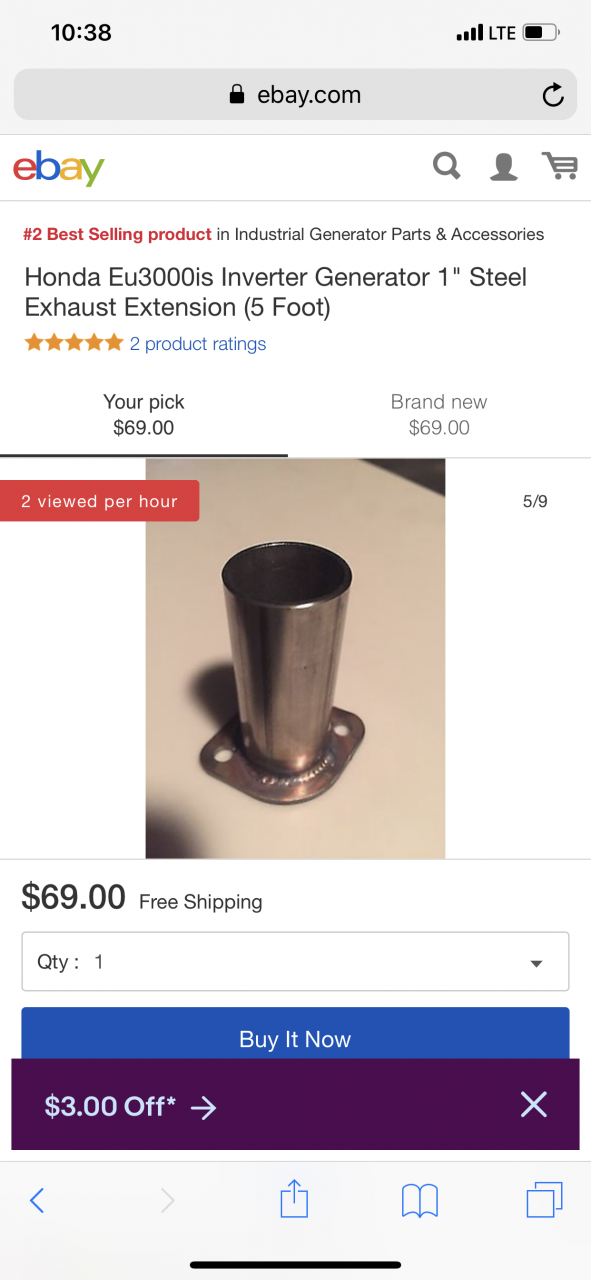

    See, this would be my exhaust area. I think it would be fine running it straight up like you mentioned. I don’t think exhaust would get through my nickel plate right there? Because on the inside is a hole! Well from the inside looking above the bed you’ll see the aluminum plate, no insulation or anything has been put back up yet. I mean water doesn’t get in, it’s sealed pretty dang good, better than I thought we were gonna get it.
    I probably pick one of these up and use the type of materials you mentioned. It’s a 5 ft extension, maybe they’ll just sell me the custom flange that fits up the exhaust.

    That is the exact same stuff I picked up at Napa for like $1.40 a foot. $69 for 5 feet seems pretty pricey.
