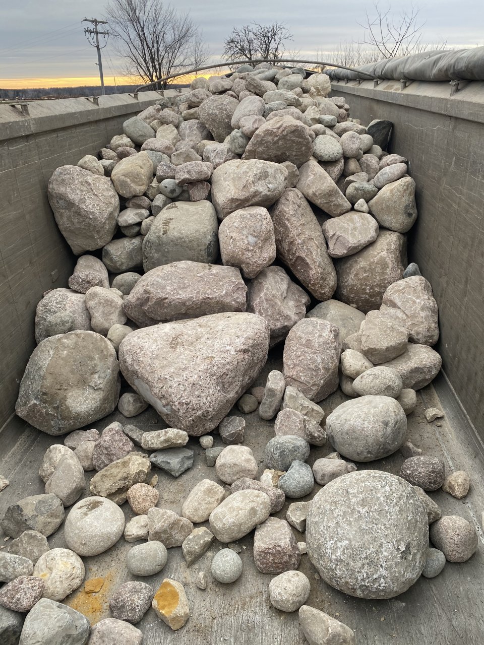

    23F31203-C244-4BDA-B186-6F5141649E02.jpeg DBF176C8-9C2C-4F0A-A2C8-C30953E79DA6.jpeg CDE62FF4-5963-494A-B4C8-2A9D4FB484A9.jpeg
    I’ve hauled some pretty big rocks in an aluminum but i don’t know if you necessarily would call them “boulders”. They weren’t impressed when I showed up with an aluminum trailer. It’s a double wall spread axle Ravens, and they loaded it with an excavator setting the bigger ones in carefully and placing them where I thought best as far as my gauges. As stated if you can barn door the end gate do it. Go up slow and once you hear them slide stop. It sounds like all hell breaking loose when they let go. Try to plop some out and pull up to avoid them breaking or one stabbing the ground and coming back on a brake chamber. Slow and steady is key.

    No I got pretty lucky and got mine dumped without incident. About every 3 months we get a load of these out of Wisconsin comin back to either Kansas City or Lake of the Ozarks. A coworker of mine did one the other week and a rock came tumbling down and popped his step off on this inside of his trailer. He found it and the shop just welded it back on.
