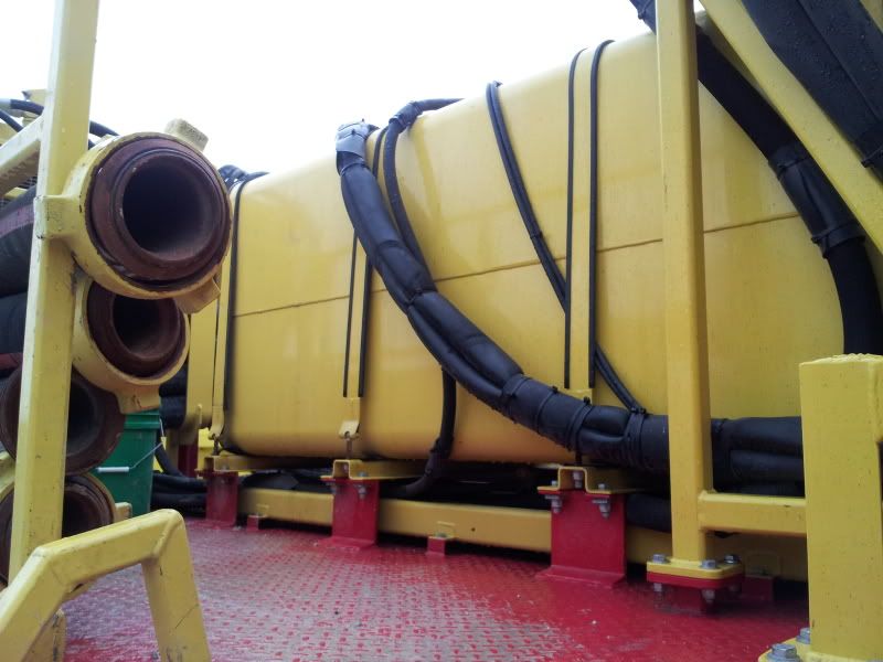

    the big one is a 300 gallon fuel tank mounted on a pump truck... no labels, no placards... the other pic is two 350 gallon totes. also not labeles but do have placards...

  6. jdm5596
    jdm5596 Bobtail Member
    14
    Mar 11, 2012
    Corpus Christi,Tx
    I was looking for a technical statement so next time I have ths conversation with the group, I have a clear statement and hopefully a legal document to quote from

    hmm.... well I guess we are not going to see much of what we can't do. more of what we r suppose to have and do. so by that it holds up as no exemption to being hazmat just because its a fuel source for the engine... no question about the two totes on the second picture, but what about the first picture with the tank. its not really a portable tank is it? wasn't made to be taken on and off

    there exists an inconsistency, the one 300 gal tank has no placard, as opposed to the 350 gal totes with placards. if the argument is made that the totes need a placard, why not the other tank?
    does anyone know if there is a limit to the size of an equipment fuel tank?
