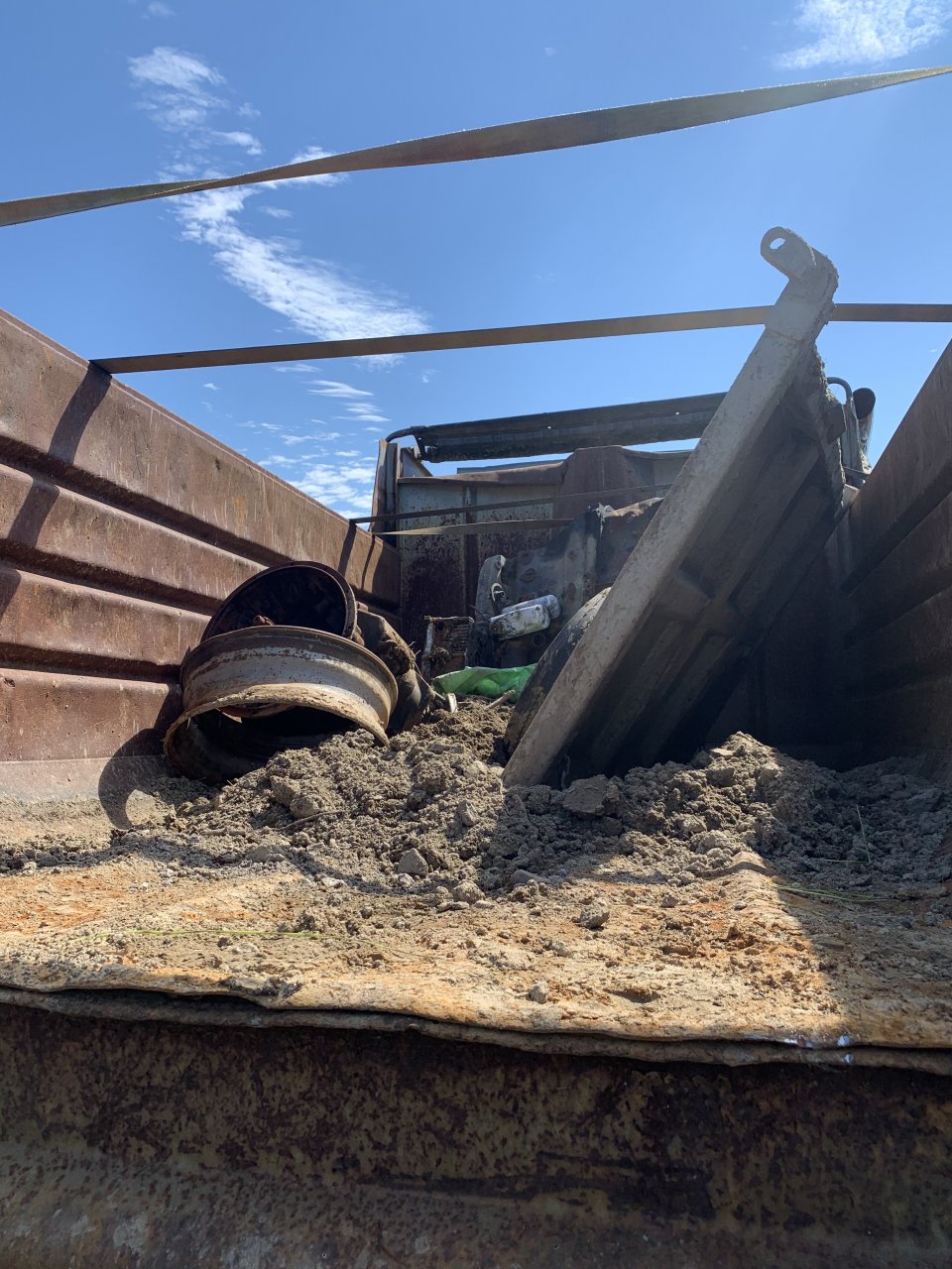

    I have a lot or respect for you and the way you go about your work, but..............You attach to the hole on the steel wheel (which I don't like anyway, but have no reason why) behind the hub, which will tend to make the truck roll toward the front of the trailer, and you also are pulling toward the front of the trailer with chains on the rear of the truck. It seems to me that in a collision or emergency braking situation that load is going to move toward the front of the trailer very easily. I realize that it can only go so far before the binder on the wheel will catch, but with momentum against it the binder could fail. By God the bed won't come up anyway!

    I see what you’re saying but it wasn’t an issue. Those two straps are the only thing holding that bed on that truck. The fifth wheel was torched off and that bed set on the truck the morning I picked it up. We won’t talk about the bonus freight in the bed. Hopefully I would be involved in loads like this in the future. E68FFD4B-2F3F-4B0F-9F93-B666A2B4AFF4.jpeg
