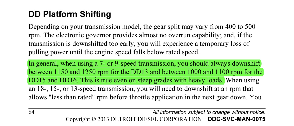

  3. PE_T
    PE_T Road Train Member
    I should add that the reason I go by speed is because I always skip gears while downshifting. If you do downshift every gear, then it does make sense to go by the tachometer, which for the DD15 and DD16 is listed between 1000 to 1100 rpm.
