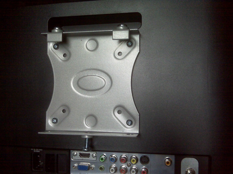

    I just bought one of the small wall mounts from walmart with a rating of 50 lbs, my 19 inch only weighs 12lbs. Im just using the part of the wall mount that mounts to the tv and heavy duty wire to hook the tv onto. I just have the wire in three loops to support the tv and I have the wire strung through the brace that holds the top bunk on the passenger wall all the way back in the sleeper. This way I can lay down and look straight at the tv. I tried to get it into the factory tv hole but you cant see the picture that high because of it being an lcd tv. So it has to be lower to get the clear picture. Its easy to take down and put up only takes a minute to hook the few wires up and hook it on my wire.

    heres two pictures of my set-up

    Well, I finally got it done. I had to do the road-testing myself but it is secure and I think suffers less vibration and shock than a tv sitting in the cabinet.
    How it was done: I ordered the laptop stand base (just the base plate that slides under the seat). I also didn't get the bottom support so it bounces up and down a little to absorb shock. Then I went and got a pole (2" diameter, 5' long) and had a plate welded to it so I could bolt it to the laptop stand base. Next I ordered an LCD pole mount (heavy duty steel, able to lock in place, also has quick release latch for easy removal).
    I did underestimate the amount of sway at the top of the pole with the tv on there while in motion. But this was easily taken care of with bungee cords, coming from three different directions. One wraps through cubby hole in the front of the cab and down through the cb space. The other two come from one of the top bolts in each cabinet from both sides. I had to remove the bolt to thread the bungee cord through.
    It works incredibly well. In the pictures I didn't have the third bungee cord attached yet. But now it bounces around just enough to absorb shock. I know it's hard to believe from looking at the pictures, but I've even been out bobtailing on some pretty rough roads and it is stable.
    I have wires running down the pole, across the floor, and through the panels to a dvd player and amplifier. I also have a VGA cable so I can use it as a monitor for my laptop.
    If anyone is to attempt this, please follow the instructions above explicitly. Or better yet, send me a PM so I can walk you through it. The total cost of supplies was about $200, not including the tv.
