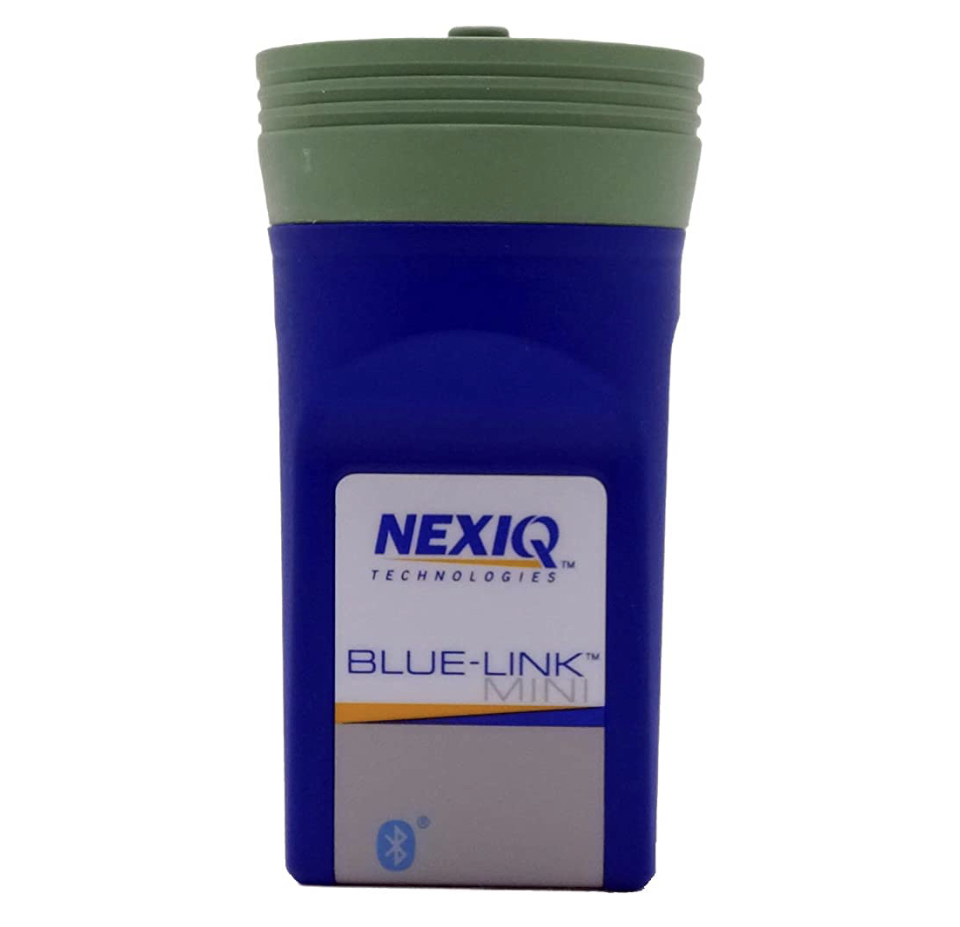

    Everyone should have one of these if you don’t have an ELD that sends you codes or if you’re looking to buy a truck.
