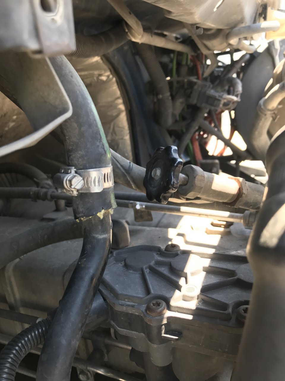

    How long does it take to start flowing? Been here about 20 mins still nothing

    Should flow immediately... you got valves open....?
    I had a set on mid frame where you hook lines and another set on water pump

    There probably is a valve on trailer, on front near where u hooked it up, if compartments may be on side of trailer.. just a wheel valve handle thing a ma jig..

    Couldn't find anything so I just said oh well shouldn't lose to much in 14 hours

    Na, for 14 hours I wouldn't have even thought about hit.. u will be good.. their has to be some valve not open or line is clogged.. to make sure it's not clogged on your tractor or lines off tractor turn on the valves so it will flow to the end of the line and use a tool like a screw driver etc to push the nipple inside the line to be sure coolant is flowing out.. that way you know it's something on the trailer inop and not your tractor..

    Guess it's something with the truck
