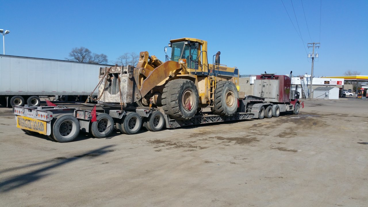

    Cpape, we run 45 and 55ton trailers that have a lift third axle, with mounting for a 4th flip or stinger, that may be another option for you guys
  7. DieselDog81

    Here's an example of one of our setups
