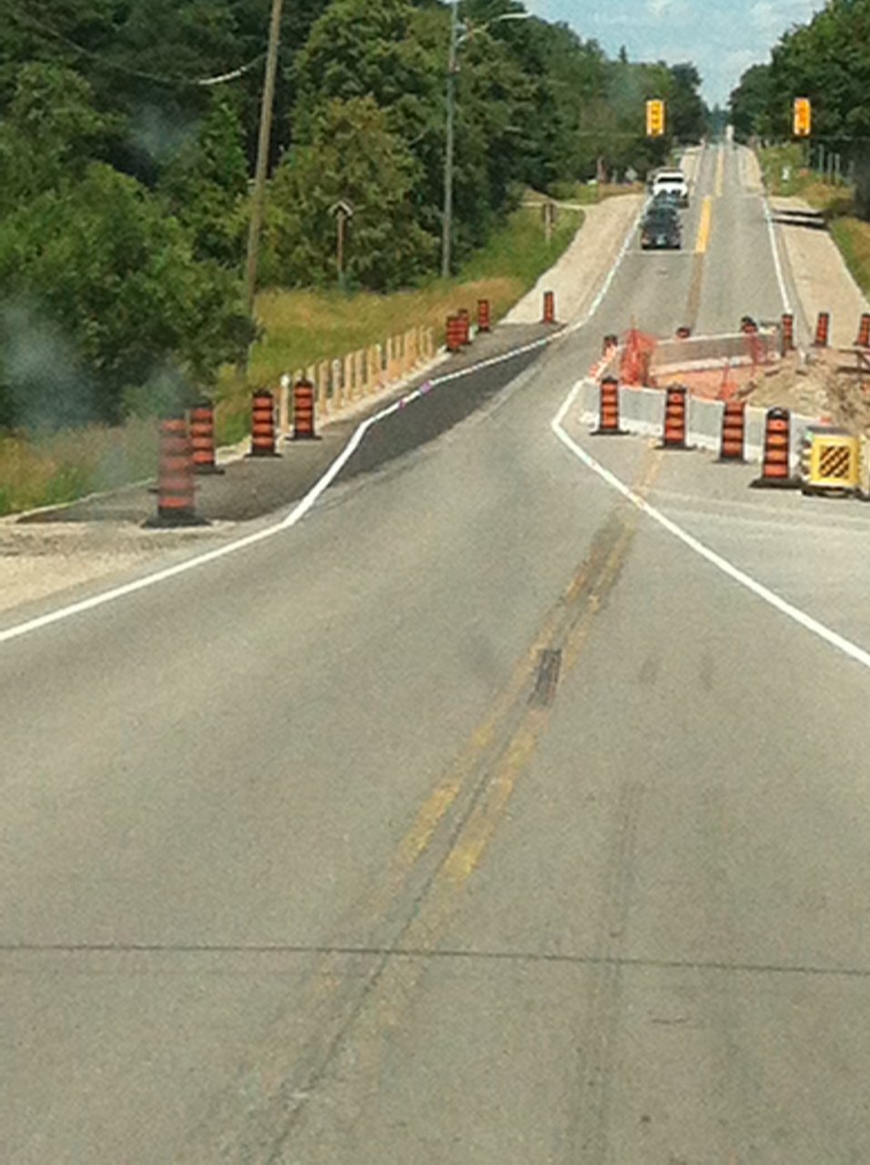

    What do you guys do for fuel, once you're loaded wide? Drop and bobtail to the fuel lane at the end of the day?
    What do you do if you're on a permitted road, and there is a construction zone where you are down to one lane? Run it slow? Get out and walk? image.jpg

    Dec 9, 2012
