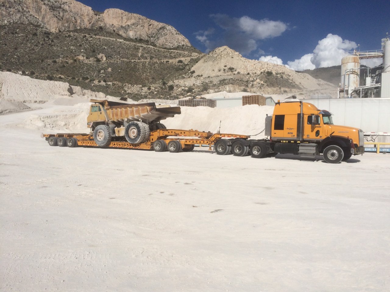

    I could explain why this doesn’t work well but I would just get frustrated. And no it doesn’t much matter if tour trailer is customor not. It is really just math and physics. Yes you can build a trailer with an extra long neck (17+ft) that will reach the fifth wheel on a 2 axle Jeep (yes you have to be that far forward to push weight onto the tractor)
    But that moves the center of weight forward on the trailer so close to the neck that you cannot load the load far enough forward in the well to get the desired weight split. That is in part why you run a booster - to move the center of weight back in the well offsetting the length of the neck.
    When you understand the above concept you will be on your way to understanding loading a HH type trailer.
    I will, again at the pain of being my usual a hole self, encourage the OP to start small and learn the underlying skills necessary to dmake the job. Things are bad enough out here with people bootlegging and hitting crap and cutting rates because they don’t choose to buy the right equipment. After all what could go wrong ? Just slap an axle on your freight truck and pin an axle on on your ragged out 35t and voila you are ready to haul 120k on the deck.
    And yes I have loaded with a Jeep and no booster and no you really can’t scale much over about 65k legally and yes the #### thing is sitting on the neck as far forward as it will go
