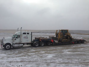

    You can't really see it in the photo but the air is out of the booster but it was still picking up the right side of the trailer. Tires are about 1/4" off the ground. Had to stop right there and the crane operator had to pick from there. The bolsters are normally even with the top of the tires on the trailer.

    The jeep I have is connected to tractor fifth wheel which the lowbed then connects to the fifth wheel that's on jeep... Like this
