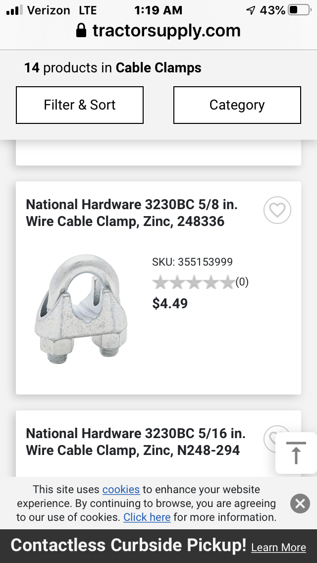

    I didn’t know you already replaced everything with new. I thought of binding them with a couple SS hose clamps temporarily.Then with something stronger. Little U bolt things from Hardware or TSC I also thought they were old and weak though. Not sure how prone Pete’s springs are to breaking. My WS would break every few yrs. sometimes doing slight damage under the hood. Bad design. My Freightliners are 20 yrs old original. I was just trying to throw some ides out there. I considered putting a couple garage door springs inside of my WS springs, same length. Wish I knew more about the Pete’s design. I always thought the Pete’s aluminum hood was a lot lighter than other fiberglass hoods. If so, had to be something you can do.

    0169436D-57D3-49B7-BC9C-8D6DC29DB63F.png I was thinking something like these. 2 on the ends of each spring.

    Hey R&R I see what you mean now with the clamps. I was researching the length of the springs. The blue ones are 21” and the black ones are 20”. After I change the J brackets and hardware I think I’ll try the shorter springs along with a proper adjustment as per woreout. I have a gap of about 3/4” to the firewall when the hood is closed and a pinch lower than the firewall cowl. I’m sure with the new parts it will be different but what is the proper gap between hood and cowl
