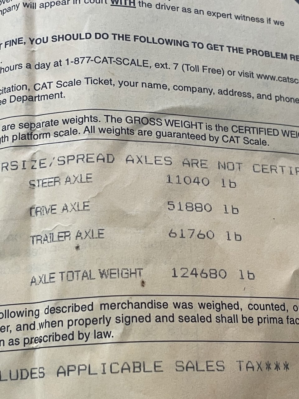

    Good morning Amodel, yes I put a drop axle on my W9. Had to replace the 120 gallon tank for a 90 gallon to achieve the room needed. Think his truck is a little longer wheelbase than mine, think mine is 250 or 253 wheelbase I can’t remember for sure. Had no issues with the frame….
