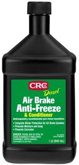

Hello can someone please tell me where to add alcohol to brakes to avoid freezing in cold weather?

    Glad hands more in emergency side than service..... pull supply line off back of compressor .....
    It’s hard in bits and pieces but it beats being frozen..........

    Don't put it through the air compressor intake or dump it down the discharge hose if your truck has an air dryer. It can damage the descicant inside the cartridge. If you're going to put it in, put it in after the dryer.
    Never use alcohol, it can dry out the seals in the air valves. Use the proper air brake antifreeze.
    If you keep up on air dryer/air system maintenance (like draining the tanks often), you likely won't have very many issues with frozen airlines.

    Long wheelbase trucks with the air drier 10 miles away from the compressor freeze the supply line before the drier........
    Ask me how I know this....:) quick fix pull discharge line off compressor fill it up air pushes it thru ..... get going......
    I Put a new cartridge on every six months anyways.......

    I remember the older cans of air brake anti freeze said to pour entire contents directly into the air dryer..
    Must be before my time- .
    Who the heck has an air dryer with a convenient cap on top and easy to access........Terrible advertising

    @AModelCat is correct. Disconnect the line that runs between the air dryer and the air tanks and pour it in there.
