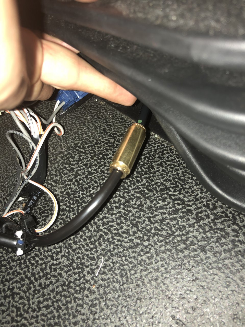

Hello, Hard Working Colleagues! Need to install airgun for cab cleaning.

    Its volvo 2018 780 and they have that thing (on the picture) made of copper on air line that goes to driver sit. My guess is thats where the air lines are disconnected and that thing holds them together.
    Had anyone dealt with and removed it, because i tried all options (pushing both ends and take it out, tried to twist it etc.) and it doesn’t come out?
    Thank You!!

    Hold the large copper piece firmly with a plyer, then push the little collar at each end in, simultaneously pulling on plastic line. These type when assembled at factory are put together by pushing plastic line into fitting. One collar at a time to pull out line. Don't have to do each end at same time. Hold, push collar in while pulling, and pushing some to get it to release. Reassembling just push in line, give a small tug to seat it in. Hope this helps, kinda of a long roundabout instructions . Thats the kid off fitting it looks like to me. Try not to destroy it.

    Thanks fellow driver, I could release one side, the other side was jammed real hard. I had to cut it.
