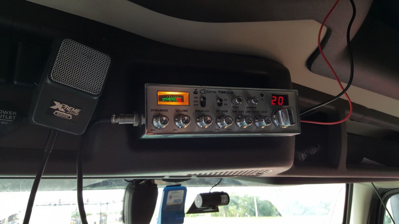

    It looks like it's gonna fall out, but it's tight as can be. No jury-rigging. Thanks Volvo designers for using your brain when designing this, the only radio "cubby hole" I don't ####ing hate. Truly able to accommodate pretty much any radio, as you can see.
    The bracket bar inside can raise and lower, on screws, as needed.
    Take note, International, PACCAR, and Freightliner...

    I couldnt agree more, Ive driven 4 different Volvos in the past 11 years and was always able to mount a large chassis radio ( General lee, 99v2, and so on) and never had a swr issue using stock antenna mount or bird perch, would like to move out of this T680 and get back into a Volvo.

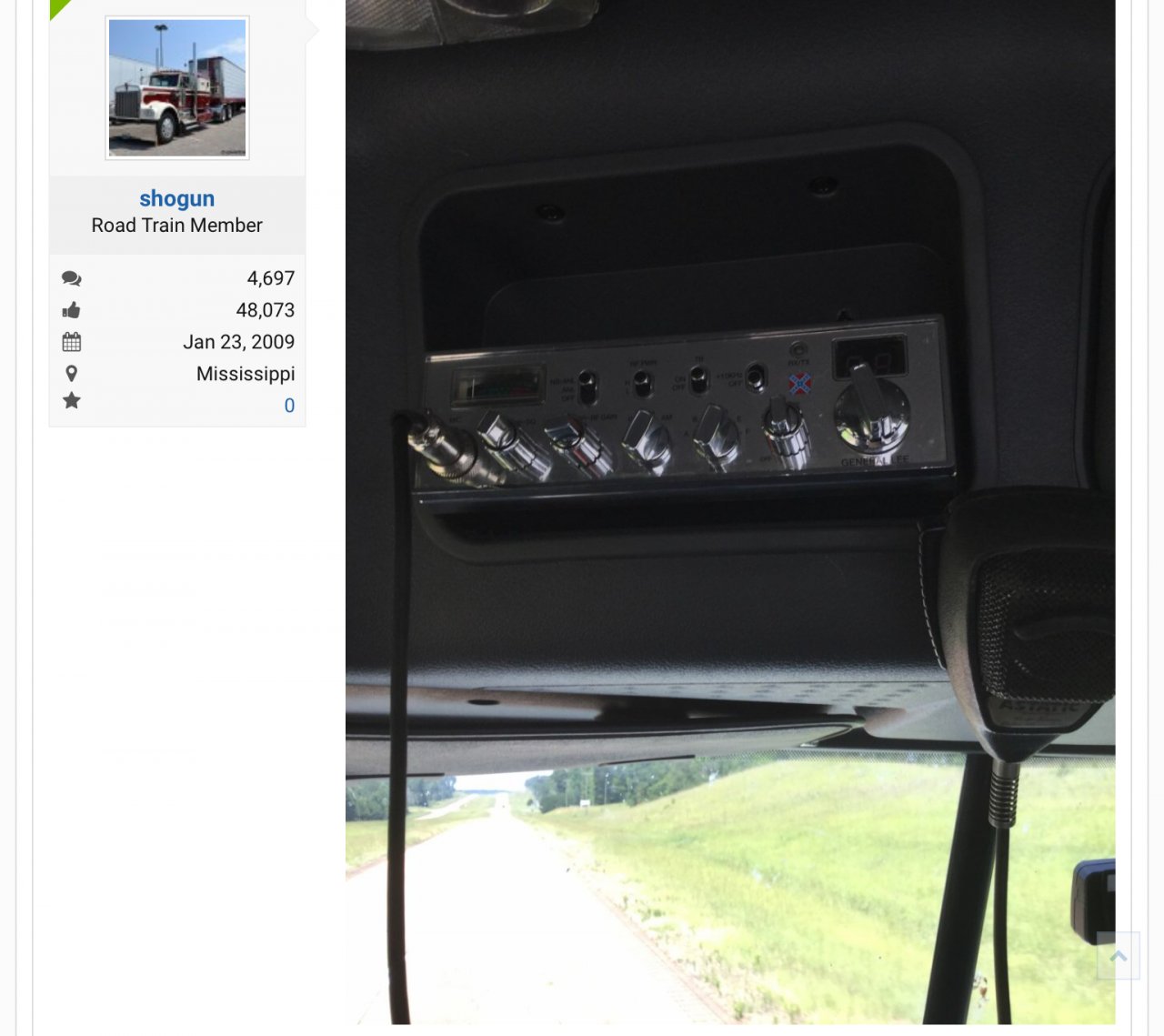

    And unless the thief carries a really long flatblade screwdriver, it’s impossible to steal. I ran a Connex 4300 In there and a small case 4 pill in the bin over the drivers head, it fit perfectly with my meter in line. The Connex had a front mic jack so it fit all the way back in there. I miss that truck.

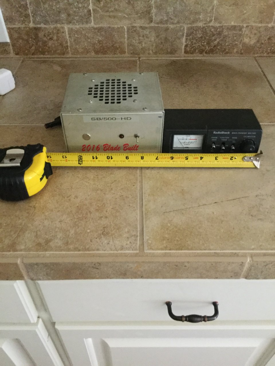

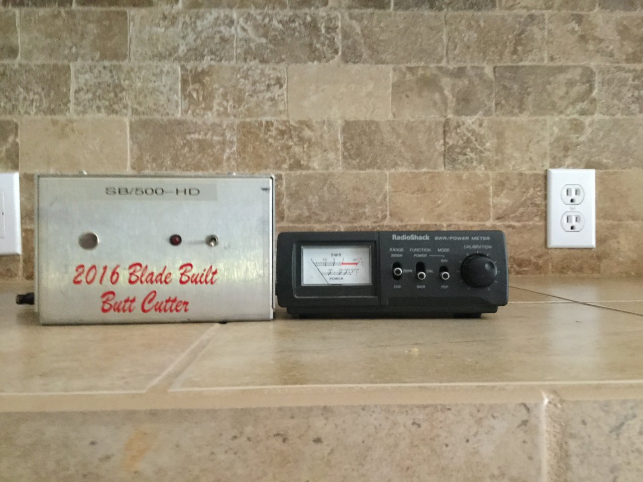

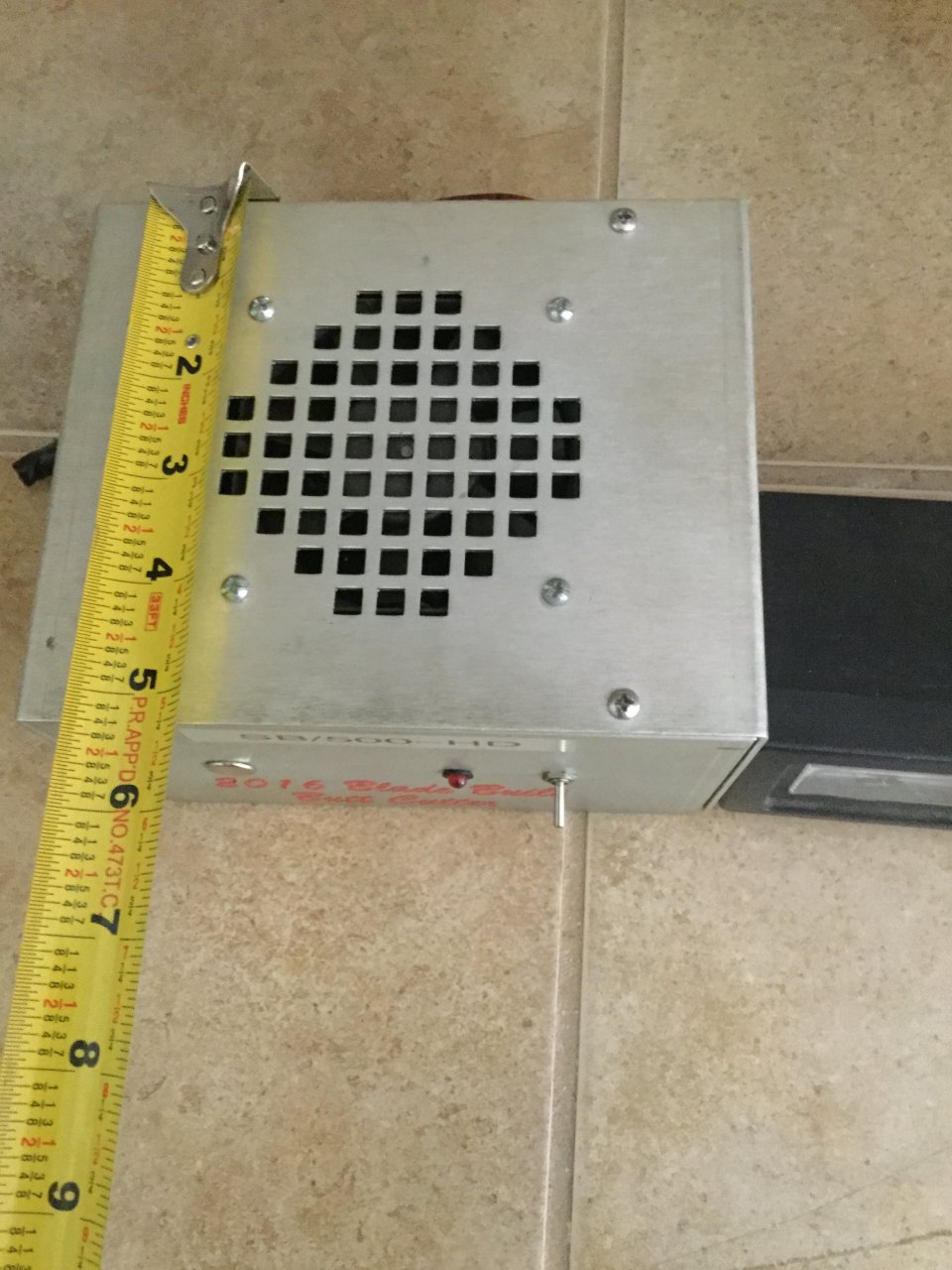

    You can run 8 gauge from the battery, hook the ground to the frame ground by the batteries or to that battery it’s grounded to. Zip tie the wires to the airlines underneath the cab, then run it up through the rubber grommet on the firewall. Squeeze it between the grab handle and go up the door, pop the A pillar off and hide it behind the cover.
    Take a few screws out of the upper console behind the sun visor, just enough to pass the coax and 8 gauge thru. I ran a Predator 10k dual coil Short Whip tuned about 51-52 inches on that Volvo hoop mount. I ground the texture off the upper driver mirror arm, put the mount on, and ran a ground wire from one of the bolts to the mirror bolt that grounds the mirror electrical on the door. The antenna probably had a 15 degree tilt. 2 watts reflect total.
    I ran a Connex 4300 with a 2290 driving a class C 4 pill running about 600-700 watts with a 40 amp inline fuse near the battery on the 8 gauge.
    I had zero interference with anything electronic on the truck, never made an idiot light come on, or mess upthe Elogs.
    It sat in the driver overhead bin just like this. That Radio Shack meter was between the amp and antenna. It’s the 21-634, surprisingly accurate at measuring avg power, peak, and swr. Almost like my Bird.
