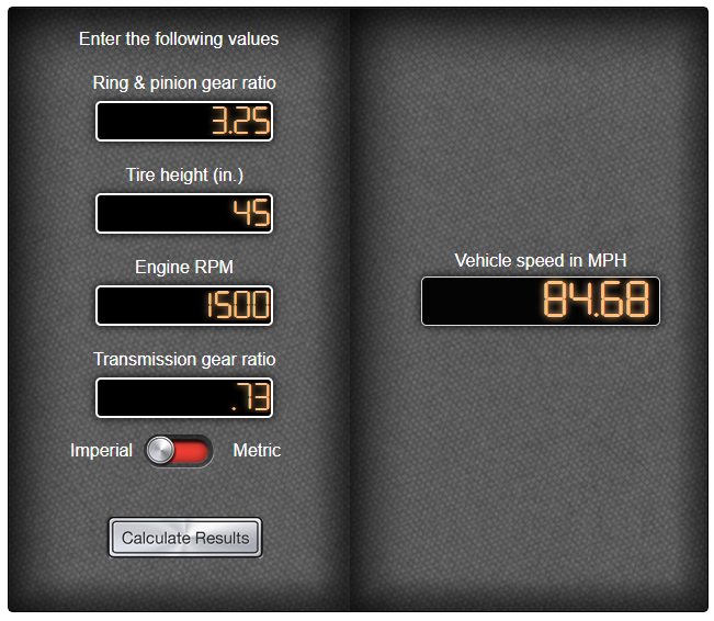

    Awesome! Best of luck on your new rig. The setup below is with 3.25 rears, 22.5 rubber, 1500 RPM and the 18's .73 final drive ratio. You can go here to play around with the numbers and see what works best for you: Transmission Ratio RPM Calculator | Spicer Parts

    Got the tire height wrong. 22.5LP would be 40in. Tall 24.5 is only 44in
    Roberts450 and Vampire Thank this.
