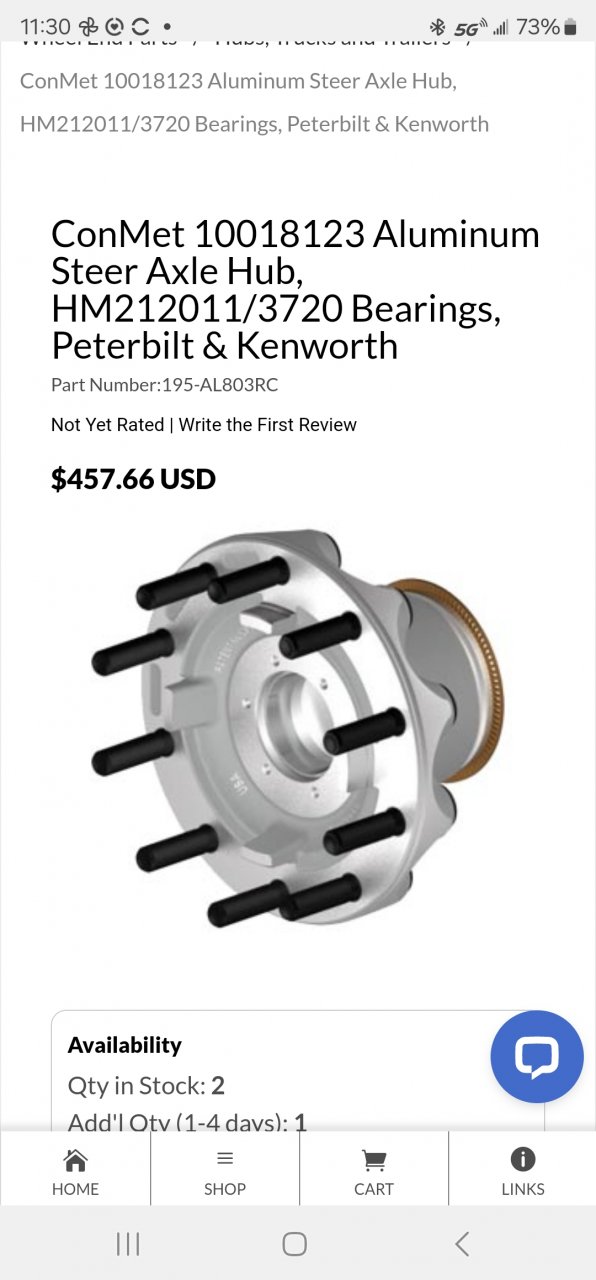

    I'll try to double check this hub tonight, bilut I think it will work. Sometimes ypu gotta do what ypu gotta do. The hub may not be exactly the same as the other side, may look different, may not be non-serviceable. I've replaced aluminum steer hubs with cast, because you just can't always get parts.
    Webb has a hub finder on their website. You'll need spindle measurements to help guide you. But, I'd just about bet money you can walk into any place, ask for a steer axle 10 hole hub pilot hub that takes a 35066 seal, and it'll work.

    Thank you,i’ve searched on the conmet website and it seems they may have something that will work.will call them tomorrow to confirm.thank you for the help
