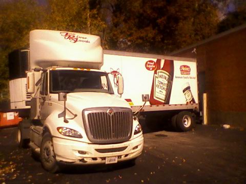

  8. motocross25
    motocross25 Road Train Member
    3,896
    11,979
    Sep 23, 2010
    Overland Park, KS
    It is tough startin out but everyone on this thread so far has given you excellent advice. Take your time, do not be afraid to get out and look and in no time you will be crankin it into less than ideal docks in an alley like this without even thinkin twice about it. Best of luck to ya bud.
